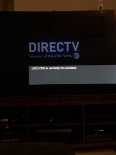

Need help/advice. A month ago I was upgraded to a HR54 and the c61k box. Ever since the switch my on demand doesn't work.
Any ideas on how to fix this issue?
