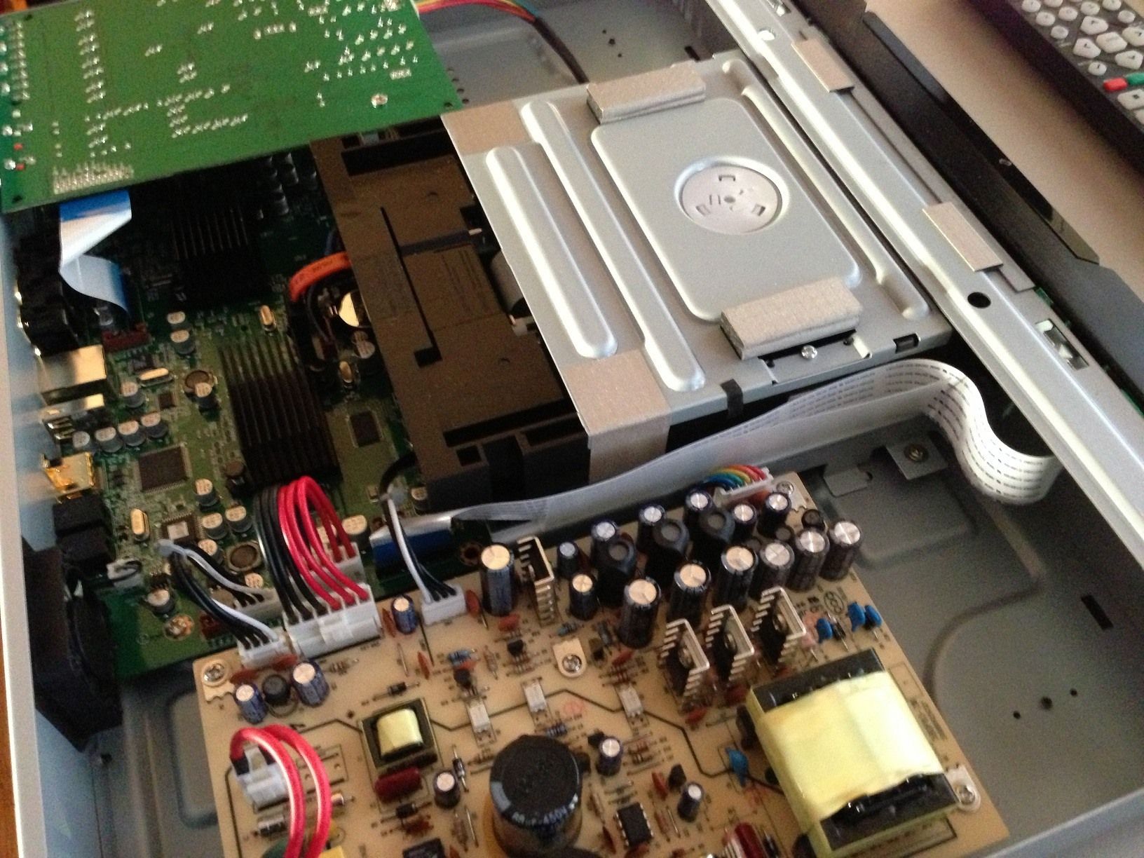

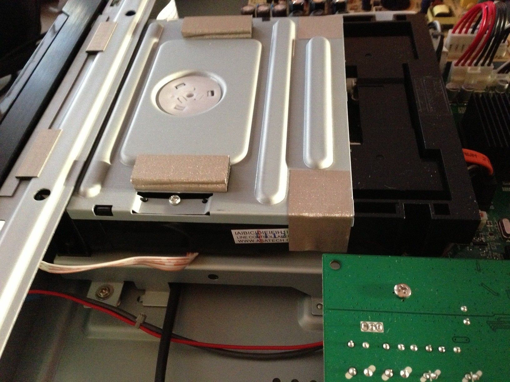

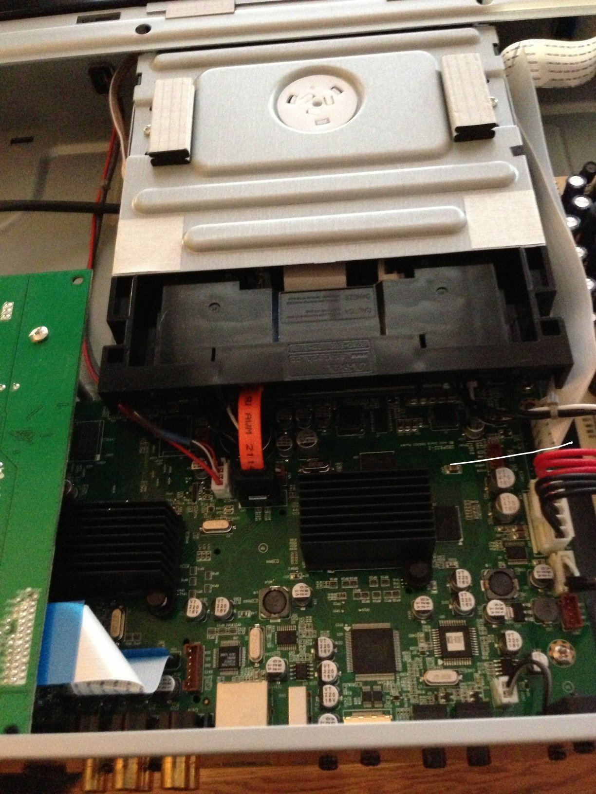

Suddenly, today I can't get the tray to open. There is no disc inside. And no pinhole to stick a bent paperclip thru. So I removed the cover. But to go further, I must break some seals and "grounding tape."
So I did a little research and found that this is a common problem. No way to fix except to send it to OPPO or buy the AY from them and install it myself. I just contacted OPPO and asked about repair options and I'll report back what they say.
Anyone else have this problem? How did you fix it?
And does the 103 or 105 use the same mechanism? I seem to remember reading here they do not, but I'm not sure.
