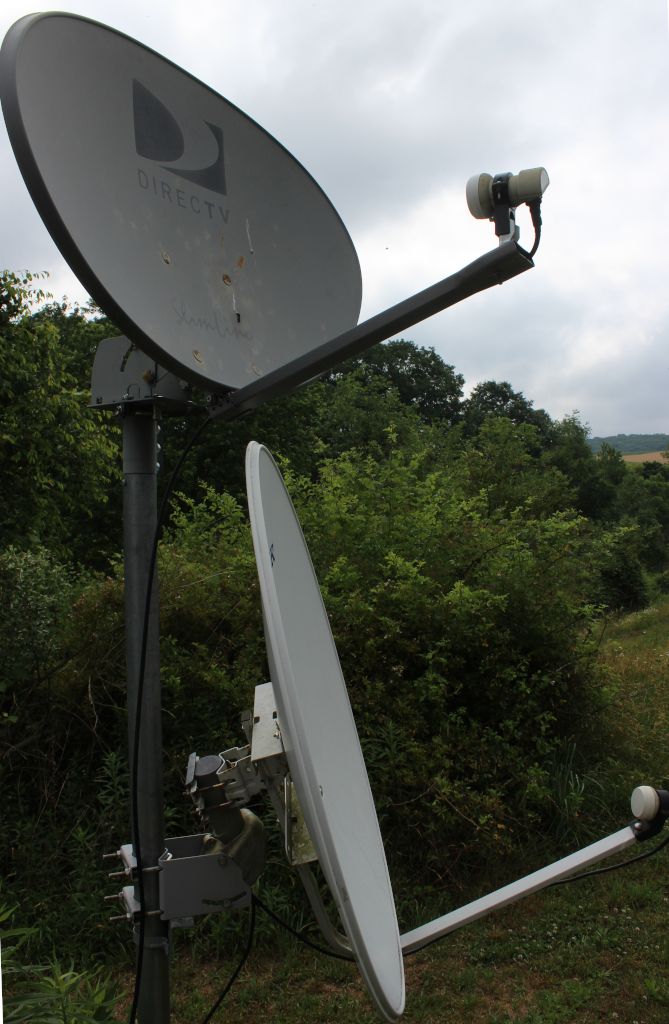

Welcome to Satellite Guys! :) Just for clarification, you mentioned the Slimline dish. Those are not from Orby. They are from DirecTv and do require modding with a different lnbf to make them useful for FTA. There are several threads here about that. Here is a pic of a Slimline that I modded for Orby use (top dish).
The actual Orby dish - the one I believe you are using - already has an lnbf that is capable of receiving FTA signals so no modification is necessary. If that is the dish you have then there may be a wrong setting in your receiver. If not then the dish probaly just needs aimed more precisely. You are going about things the right way as having the receiver and a tv at the dish will allow you to see changes in signal more easily. Be sure to move the dish in TINY increments and wait to see any results on the receiver. We are talking about fractions of an inch so it is easy to do a sweep too quickly and pass right by the signal you are looking for.

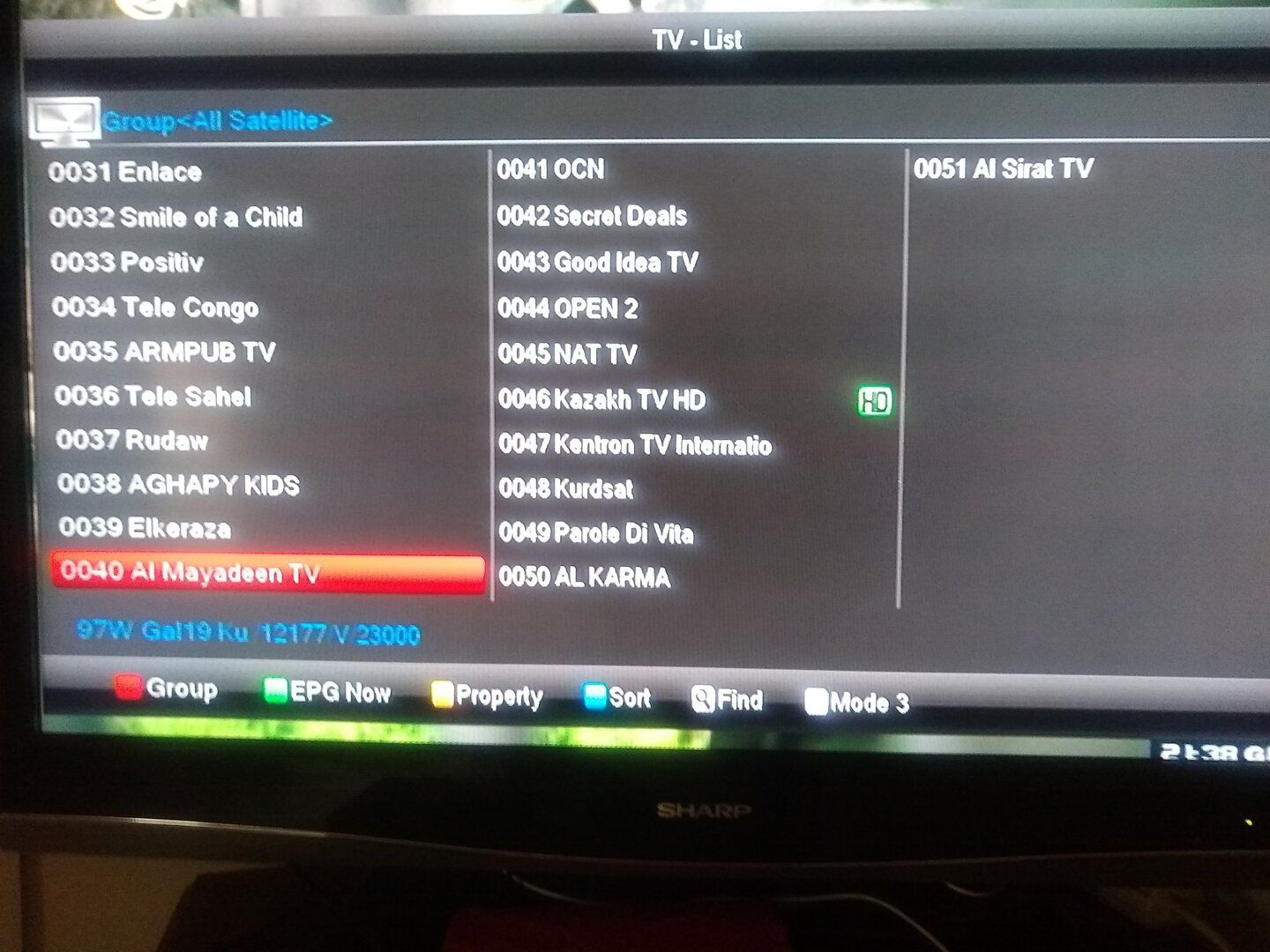

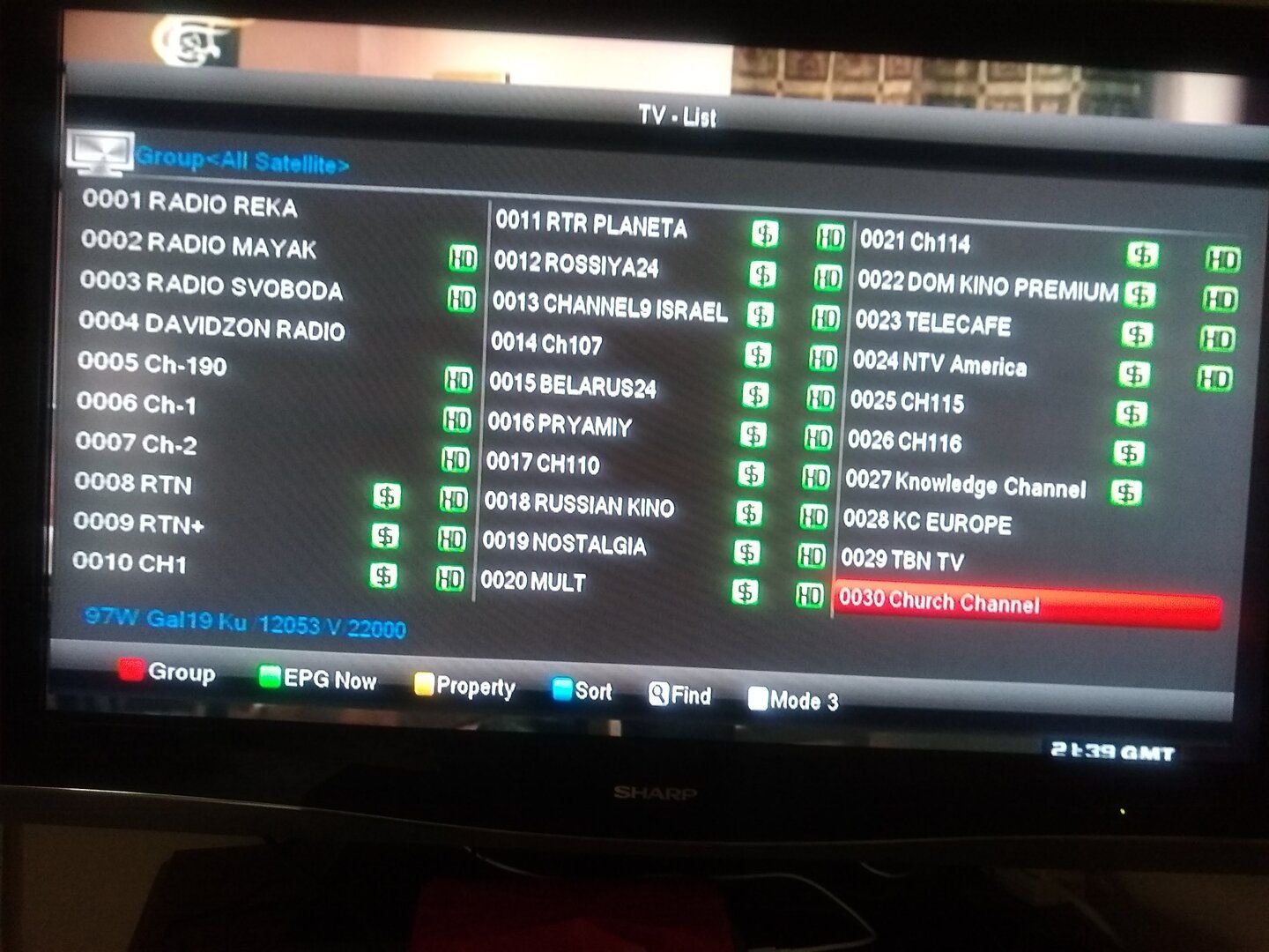

Success!!! This pm, under clear sky, I re-aimed the dish. I had my other half stand in front of the dish, using a compass, she located 225 West, I had her hold a stick to point in the direction, me behind the dish pointed in that direction and bam!, I got 51 channels. But, I still can't get 12152h20000. Most of these channels are at 98% level and 65-70 quality.
View attachment 151535View attachment 151536
Making progress! From the channels returned in your scan your dish is aimed between 97w and 99w as you are getting channels from both satellites. Still need to go a tiny bit east to lock only 97w. Be sure to mark everything (azimuth, elevation, skew) before adjusting anything so you can return to the spot you are at now if you get lost. Keep up the good work! :)

It was exactly what you said Michael, dropped it down slightly and to the left, So I will move it slightly to the left by a coupld of degrees. I mean this is what I call knowledge, from the little info I am giving you are able to determine what needs to be done, Bravo to you!!!

So I just went outside and a slight (a couple of degrees East), brought in 12152h20000 at level 99 and quality 90. You are a genius!!! thank you for your guidance. I am now getting 120 channels, did I say fro free? Correction, I am now getting 153 channels.
