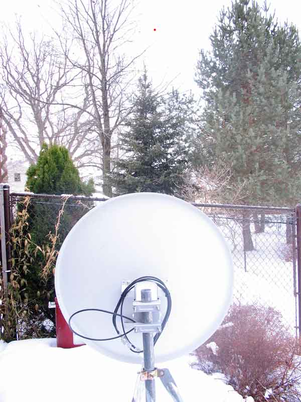

1) Basically you will set the latitude on the side of the motor and leave it alone.
2) The dish elevation bracket setting will start at the 23.5 degree mark (approximate ). That is 30 degrees minus the declination for your latitude. Once you see the markings on the bracket you will laugh at the idea of setting it with .01 degree accuracy. This is going to be your second adjustment point, after azimuth.
You've basically got the technique. I've found it much easier to do it on the ground on my deck with a tripod mount, that I can perfectly level. Then, when I'm on the roof, all I have to do is get the azimuth adjustment, the other angles are just fine.
