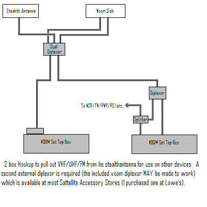

There is a method of doing this without having to run a second downlead all the way from the antenna's. Keep the standard diplexor up at the dish, and connect as below. You can purchase a diplexor at most electronics stores for use as illistrated, or you can use the voom supplied one from the back of the box, but will require a couple female-female couplers to get it connected.
