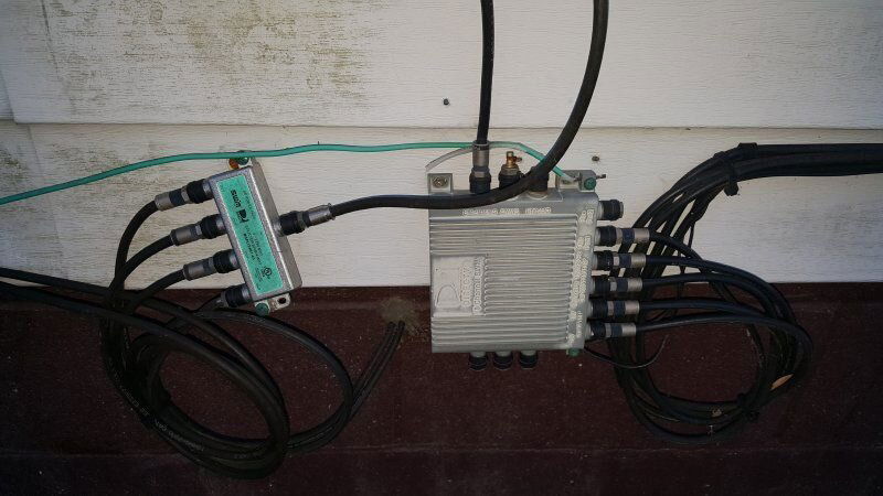

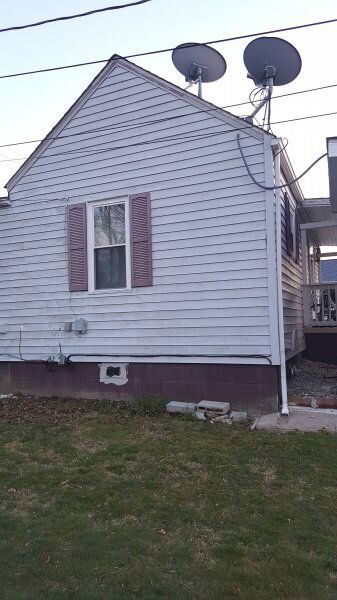

My home has the following set up: Directv 3 LNB dish plus Directv international dish.I do not need them anymore.How do I use the existing hardware from these dishes to install an Outdoor antenna to get OTA signal into multiple rooms of the house just like the satellite signal was.From dish the cable goes into swm and then into a spliter.Photos attached.

Quite busy right now myself, but your best bet is to remove the dishes and use the mount for the dish to mount a proper OTA antenna.
To answer this question only, you use the coax that connects to the worldDIRECT dish to connect the OTA antenna balun to the input of a new splitter (one that isn't DIRECTV-oriented). Make sure that the splitter passes power on one port (you're almost certainly going to need a preamplifier if the guess about your location is correct).
