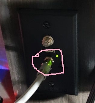

Ok, I took a look and I was wrong.....the circle in the picture is where the ota antenna comes in, light is booster on! So I can just attach the ota tuner adapter there and then to the wally and I should be good to go, right? :)

Yes, a coax from the output of that amplifier to the OTA adapter and then plug the USB from the adapter into the Wally. You will have to do a scan of channels to get the stations.
