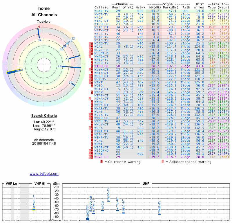

ok put in my info, and yeah it seems about right for how it is but it says i can prob get one channel with rabbit ears ... and no you get nothing unless its outside set up.
Yikes!
Not pretty.
WJAC - NBC, Metv, Comet and Grit , not a bad lineup.
Is That Fox Channel that shows 11 miles away behind a mountain?
WJAC - NBC, Metv, Comet and Grit , is what im aimed at now but get a jumpy reception, fox i think is behind a ridge but fox if i turn over that way, comes in good. thats why ide like to do a stack to get fox and cw and a gang to up the gain to try and keep the channels a lil more stable
