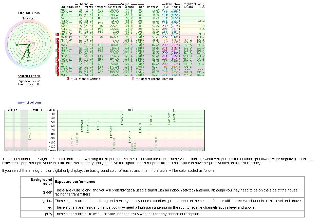

Channel Master CM4228

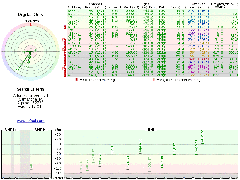

I also saw your query listed your antenna height as 12', here it is again at 22' as 12' might be a bit understated.
I'd go with the Channel Master 4221. The 4221 has a wider beam than the 4228. There is 24 degrees from CBS to ABC/NBC/FOX.
