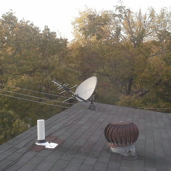

I listed that my GE j-mount is 1", but in reality it looks no wider than 3/4" maybe. I'll have to climb back out there with my tape measure to double check it before I go and get a long pipe to use as my mast. I'm thinking maybe a piece of 6 to 8 foot electrical conduit might be good enough?

I definitely would use something stronger than conduit, even for temporary testing. Maybe you have a spare piece of wood laying around? 2x2 or 2x4?

And NavyChop, I'll definitely steer away from conduit if you believe it not strong enough. I mentioned conduit because it's fairly inexpensive (vs plumbing pipe), and my little GE yagi is pretty lightweight. I'm using an old sponge mop handle out there shoved down into the j-mount for the moment; clamped in place with a u-bolt to prevent it from spinning. lol
Once I go back out and measure the j-mount, I can get an idea for what diameter mast I need for this current setup.

For the GE ant CONDUIT should be strong enough. What is the model number on the GE ant? Try a RCA ANT-751 instead of an amplifier. You have to capture a strong signal before amplifying to get the best results.

Since I'm working on a shoestring budget, I will have to continue doing my purchases in small increments. In order to go to a full sized (1-5/8") antenna mast, I think I would have to purchase a different antenna. I don't believe the little GE antenna's u-bolt setup goes much larger than 1inch. That is why I've been trying to find a smaller diameter material to use as a mast, as opposed to the standard. I guess I should also double check that measurement when I can get back out there again too.
Before you give up on the antenna, consider drilling another hole through the mast to fit a larger radius u-bolt. Not a solution that will survive a fresh gale, but it should allow you to continue your proof-of-concept testing.
