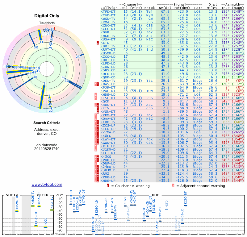

Sure. I had checked out AntennaWeb.org a little bit earlier, but hadn't stumbled across this one yet.

However, my experience with living in Fort Collins for 30 years is that the stations are all up on Lookout Mountain or nearby Mt Morrison. Those stations are all on the far west side of Denver and beam east. They are also high up on mountains, so local terrain is not an issue.
I can't speak for your particular apartment situation, but I would certainly try a GOOD indoor antenna, like a TERK. I was able to get acceptable signals from Lookout Mountain at my location at the Windsor exit of I-25, which is nearly 60 miles away. You should have a good shot at <15 miles.

And yeah, the big four of ABC (7), CBS (4), NBC (9), and Fox (31) are all on Lookout Mountain to the west.
