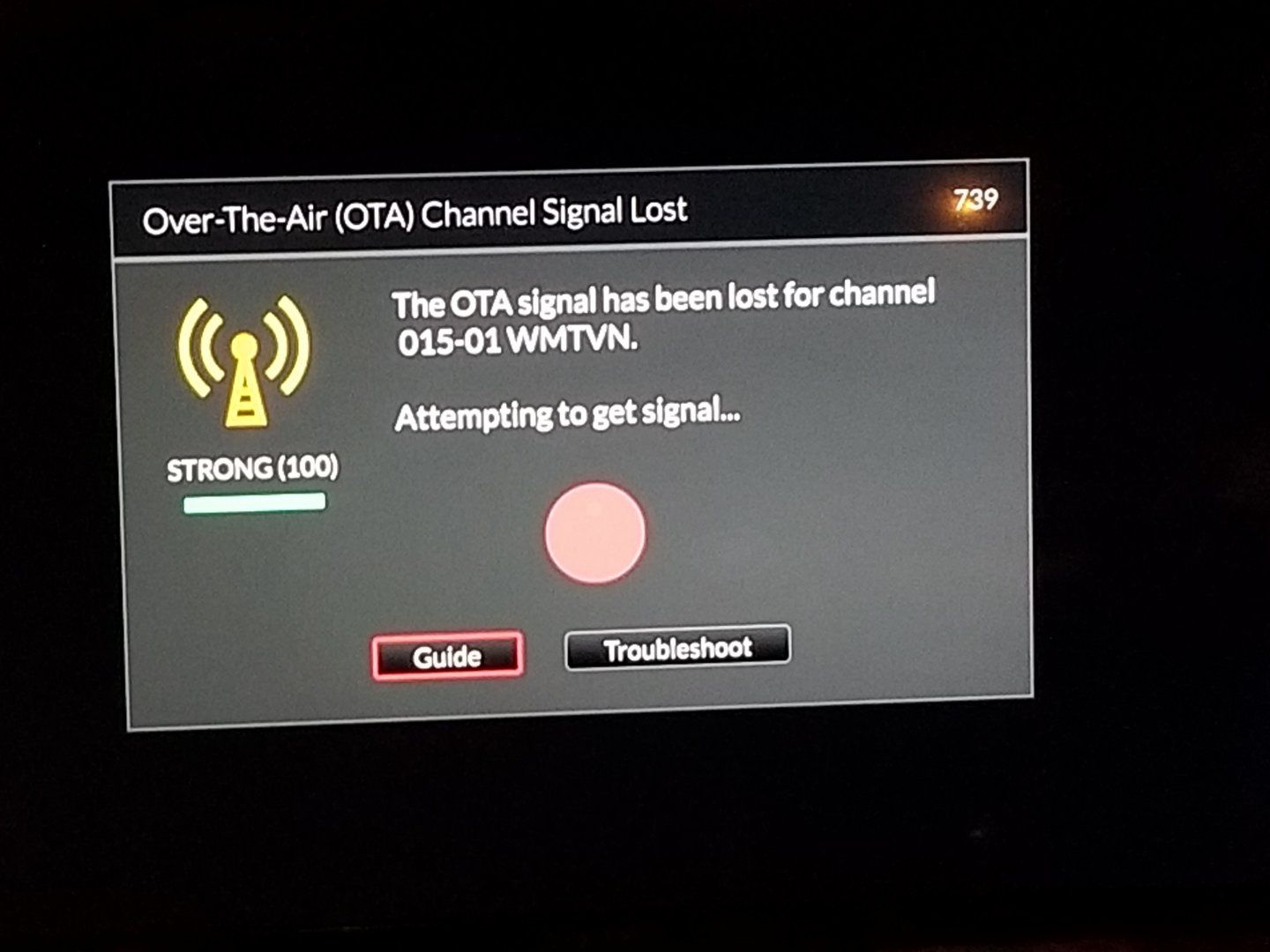

I've been getting occasional error 739's on OTA channels for over a year now. The only solution the Tech. that came to my house had several months ago was to try a different dual tuner dongle, which didn't help. I use a rooftop antenna with all channels showing 100% signal.
Lately I've also been experiencing audio dropouts on some OTA recordings. The only thing that seems to fix that is a re-boot.
Dish please fix the OTA problems.
100%? :confused: Is it the same channel or channels, or do all OTA channels do this? Does your rooftop antenna have an amp? Perhaps the signal is overloading the tuner. Yes, I am grasping at straws.
It occurs randomly with all of my OTA channels. The error 739 message can usually be cleared by changing channels back/forth. Sometimes a re-boot is needed to fix it.
I have a small Channel Master UHF/VHF antenna on the roof with no amps needed since we are only about 12 miles from the stations. The signal is split between three tv's, the H3 and two FM receivers so I don't think it's overloading anything. We've had the same setup since way before the OTA problems started showing up. My belief is that software updates introduced the problems.
I have the exact same problem. I'm unable to watch most OTA recordings unless I do a fresh re-boot. Think I need to replace my Hopper 3?

A re-scan does fix it but like a re-boot the fix is only temporary. Like I said it usually can be resolved by changing channels and then back to the problem channel but there are times when a re-boot is necessary. The biggest pain is when the channel is locked up with the error and it blocks a recording from happening. It's been going on for so long now I've kinda gotten used to it. The audio dropouts that started occurring recently are the biggest annoyance right now.
