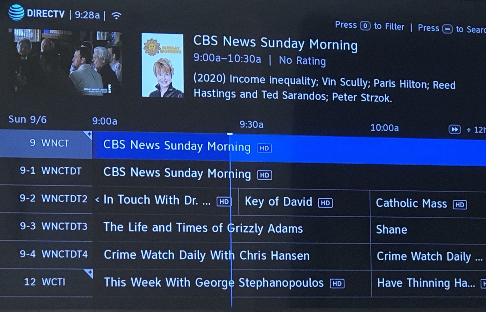

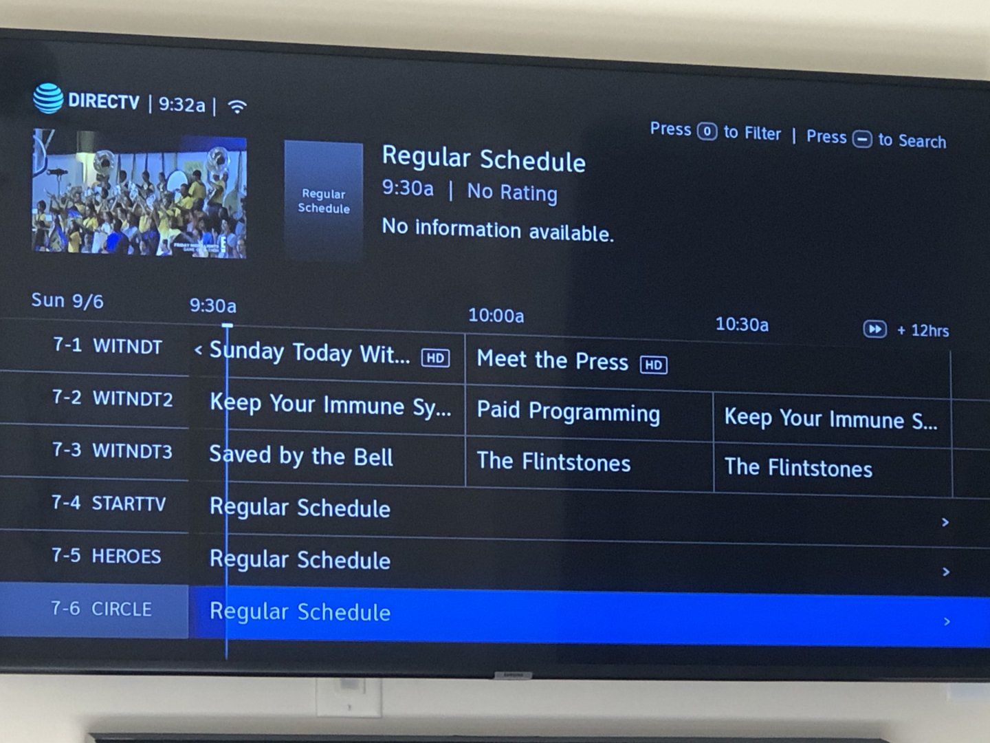

Sub channels appear like this
Do the sub channels have specific channel numbers to pull her guide data?
They don't use the specific channel numbers to pull the guide data, they use TMS IDs - basically numbers that have been assigned by Tribune Media Services or their successors. For ones with a TMS_ID over 65535, Directv uses a defunct number under 65535 (because their guide data system apparently can't handle larger numbers) and some type of internal mapping. They've deployed that across most DMAs, but a few remain that they never got around to it and those are missing some subchannels.

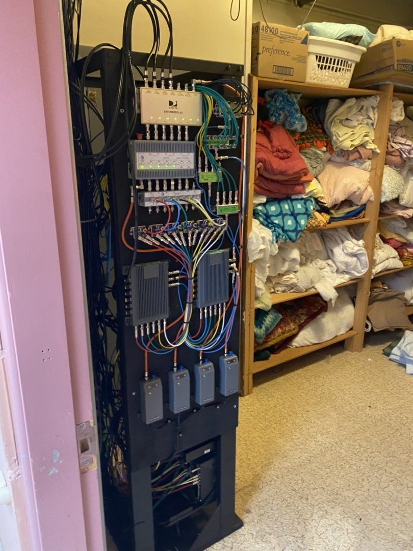

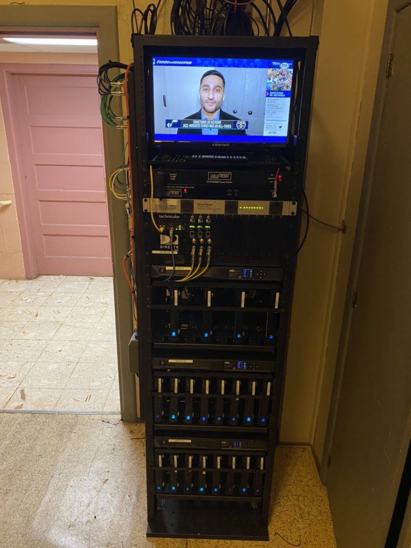

Pulling 61 channels on this...
Silver unit on top is taking 8 OTA Channels and converting to 35 QAM channels including all sub channels.
Com2000 is providing guide and (6) religious SD channels. Have guide data for all satellite channels and 8 major network channels.
First zee vee is providing 4 Hd channels from h35's
2nd and 3rd zee vee is providing 16 SD channels with H25's
It's in a church retirement home.

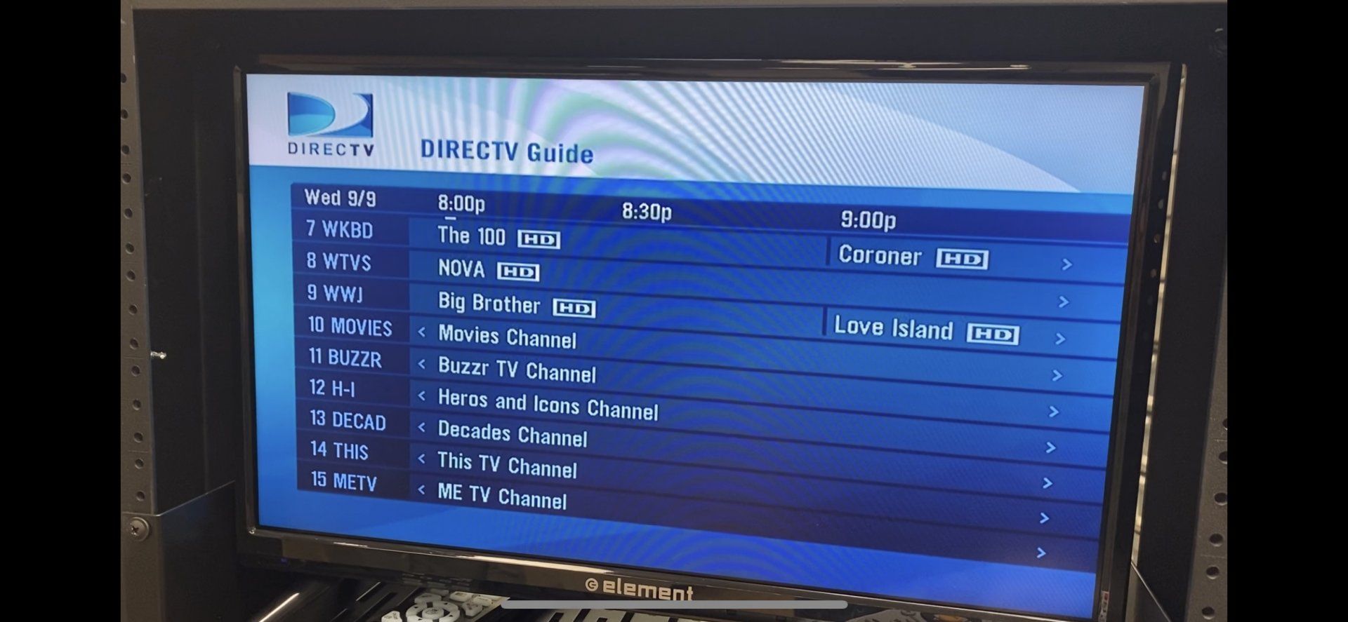

No, I think Claude means 61 channels in all for the entire headend system, satellite and OTA ...
8 primary OTA channels (with guide info.)
27 secondary OTA sub-channels (*without guide info.*)
4 satellite delivered HD channels (with guide info.)
16 satellite delivered SD channels (with guide info.)
6 more satellite delivered SD channels (with guide info.) from the COM 2000 system which provides guide data for both systems....
Total = 61 channels
In the above it's the 27 OTA secondary sub-channels without guide data for some reason are the problem ....
