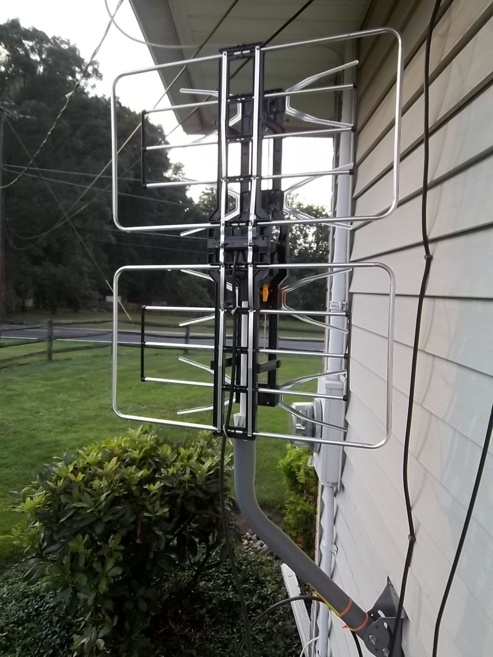

Yes, you can mount a TV antenna on an old satellite mount, here is a picture of an OTA antenna I bought, mounted on the side of the house, exactly where my DirectTV dish was. I wanted to see, before doing a roof installation, how the antenna would work at that spot. Since my location is 280 feet above sea level it worked reasonably well for a start. My location is equidistant from NYC and Philadelphia, about 50 miles from each city.
After a few months of using it at a low height I moved the antenna to the roof, and got better results at a height of 22 feet. This antenna comes with a rotor and pretty good preamp so now I get around 60 channels.

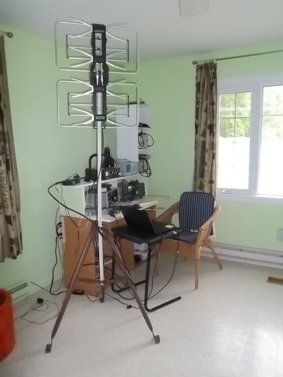

Before I mounted the antenna outside, even tried it in the house mounted on a tripod. It worked well enough for me to pursue moving it outside, then up to the roof.
Digital TV seems to have a bit of voodoo built into it, you might have to try different spots to see which gives you the best results. I am in a fringe area so a rotatable antenna and a preamp are a must.

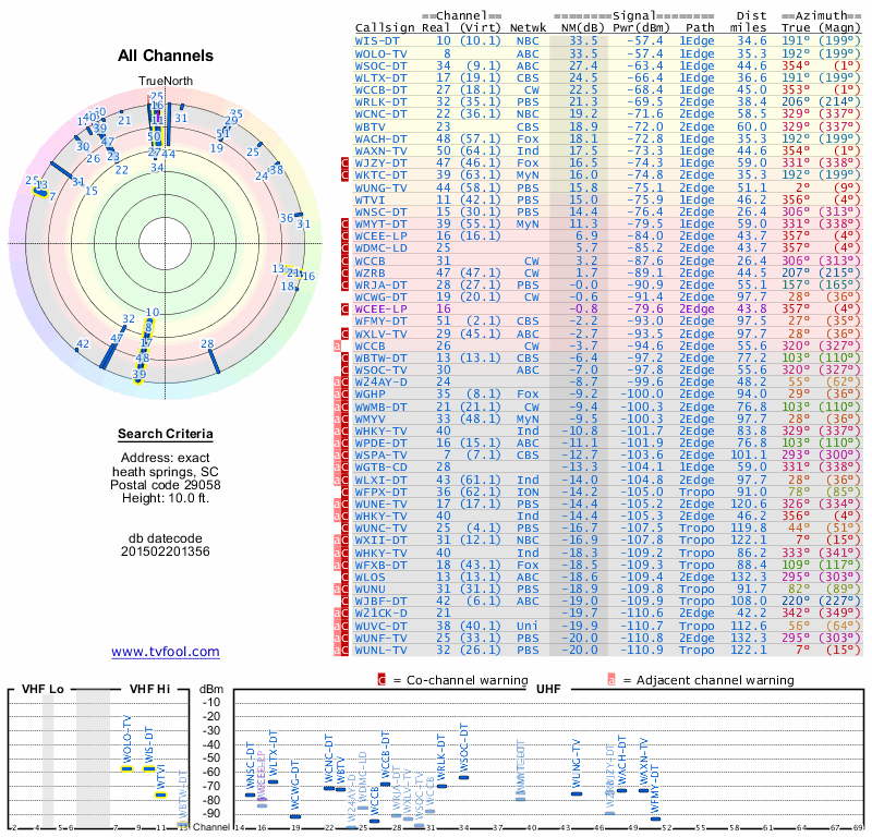

Thanks for all your replies. I tried to post my TVFool report but it kept saying I couldn't post it because the message contained what appeared to be spam. I guess I was doing something wrong.
That said, TVFool does say that it doesn't take into account the terrain and obstacles such as trees, which is my main problem. According to my report, the closest tower is 26.4 miles (which I have never been able to pick up) and the farthest is 60 miles (some are father, but theose are the ones I'm most interested in receiving). Three channels are VHF-Hi, the rest are UHF. The majority of the towers are to the north. The house faces the south, with trees in the yard, but I can shoot the gap between them. There is a large oak behind the house making it difficult to aim north. I know the seasons make a difference, especially in spring/summer with full foilage on the trees. The old CM I had was about 15 ft. or so high, pointed S/SE. It wasn't high enough to clear the side of the house, so that definitely affected any signals coming from the west. However I was able to pick up fairly well, pulling in from a station 60 miles away, as well as picking up some of the northern signals. Of course weather and the seasons did affect the strength/range.

You're right about terrain and TV Fool, it doesn't really account for that. In my location, TV Fool shows that I'm just about sitting on the Providence stations and should have no problem receiving them, but I don't even get a blip from them because of a big hill between me and Providence. But, the TV Fool report is still very helpful in lots of different ways and a lot of times members are familiar with whatever area is being checked out and know the terrain and all the little idiosyncrasies of the area.

Finally! I was able to post my TVFool report!
Boba, you said having the old CM pointed SSE might be my problem picking up channels from the north, however when I had it pointed north, I was picking up less channels. The trees are a problem pointing it north. I was picking up some the channels out of Charlotte with it pointed SSE. This area is considered the Charlotte, NC DMA, but I can get most of the Columbia, SC stations.
Thanks to A Raine for info about the preamp. If I have to have one, I'll look for one that runs the power through the same coax as the signal.
Hope this gives you guys the info needed to give me some good advice.
