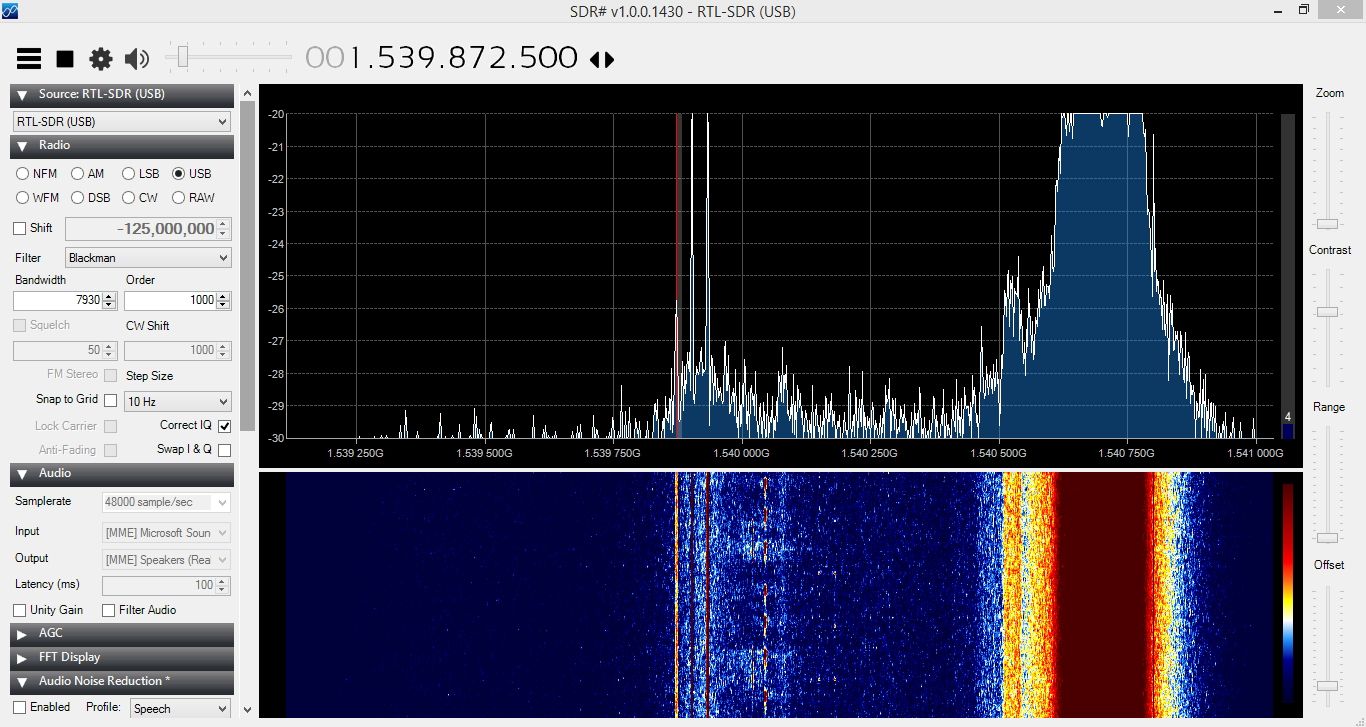

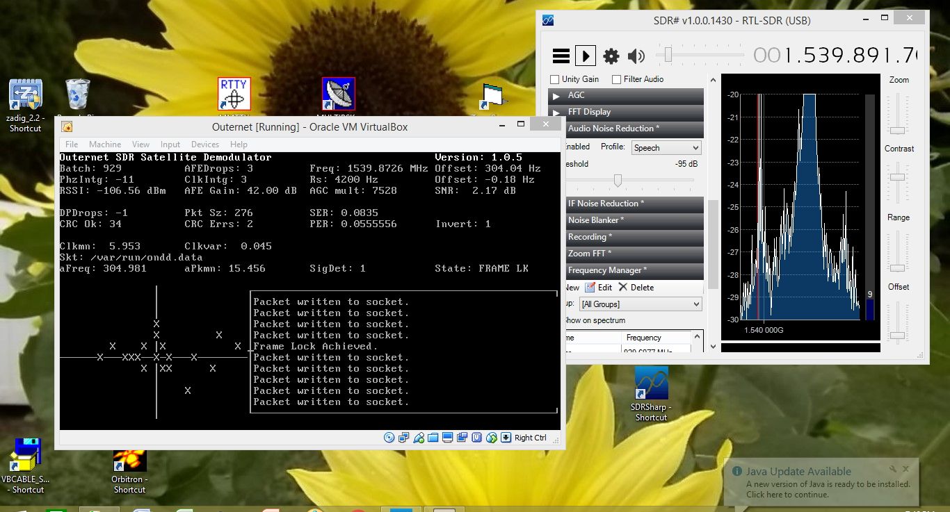

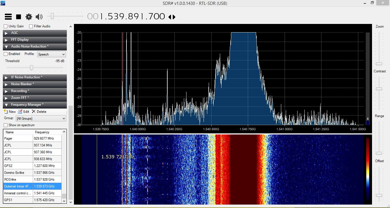

After months of trying finally got the Outernet signal using a 30 inch Ku band dish and L-band helical. Signal is on Inmarsat 3F4 at 98.14W. Dish was rotated to 235 degrees using a compass, and elevation was adjusted for best signal. Published frequency is 1539.8725 but my dongle is a bit off frequency. Using Outernet In A Box software to test that the signal is truly Outernet, you can see it has locked onto the signal. Next is to decode whatever they are sending.
You use SDR# along with the Outernet In a Box software. Details are found on the RTL-SDR.com blog.

Update: the dongle was calibrated today against a NOAA weather channel and now the Outernet signal is exactly on frequency that was published. Shouda' calibrated it first before going off half-cocked.
Duhhhhhh! :sorrow

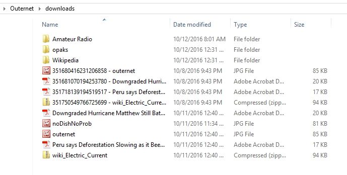

List of downloads from the Outernet this morning, some photos, some news about deforestation slowing in Peru, Wikipedia topics, etc.

One download from Outernet, hams using APRS via the ISS.....
I was tracking the ISS APRS about 4 years ago, I see now that there a lot more APRS messages.
I was using very old decoding APRS software, my Bearcat Scanner and a mobile 2 vertical in the house.
4 years ago, I was laid up with a fracture ankle, at the time and it took me about a month to work out the kinks in the set up.
What are you using as a APRS decoder and was the file right off of the ISS passing overhead???/

No it wasn't the ISS passing overhead, looks like the APRS loggings from the ISS that Outernet sends users.
No APRS decoder needed.
