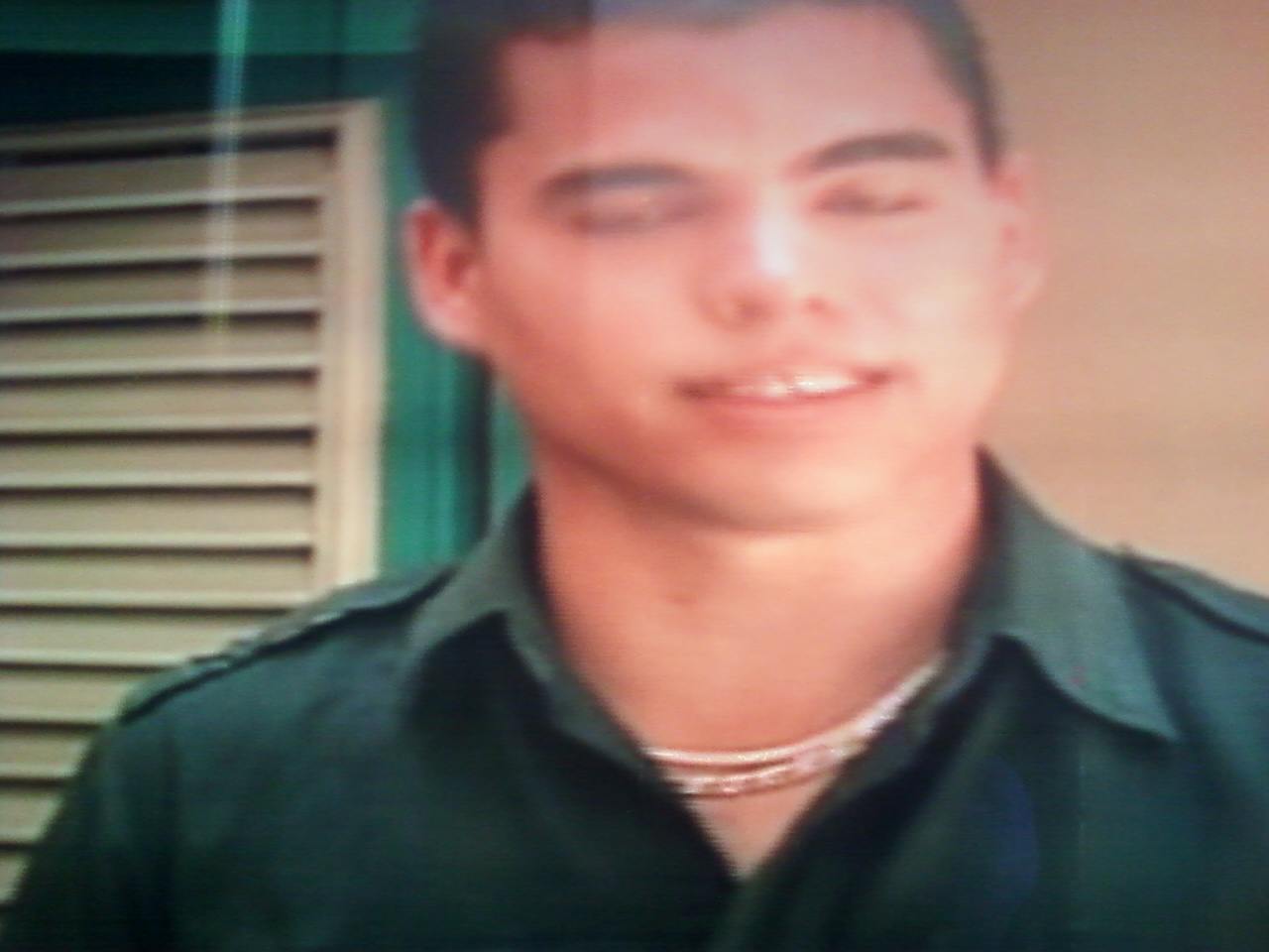

yah i've have the same problem on mine since day 1 on all SD channels. don't know the cause yet. attached pic doesn't show it well but.....
