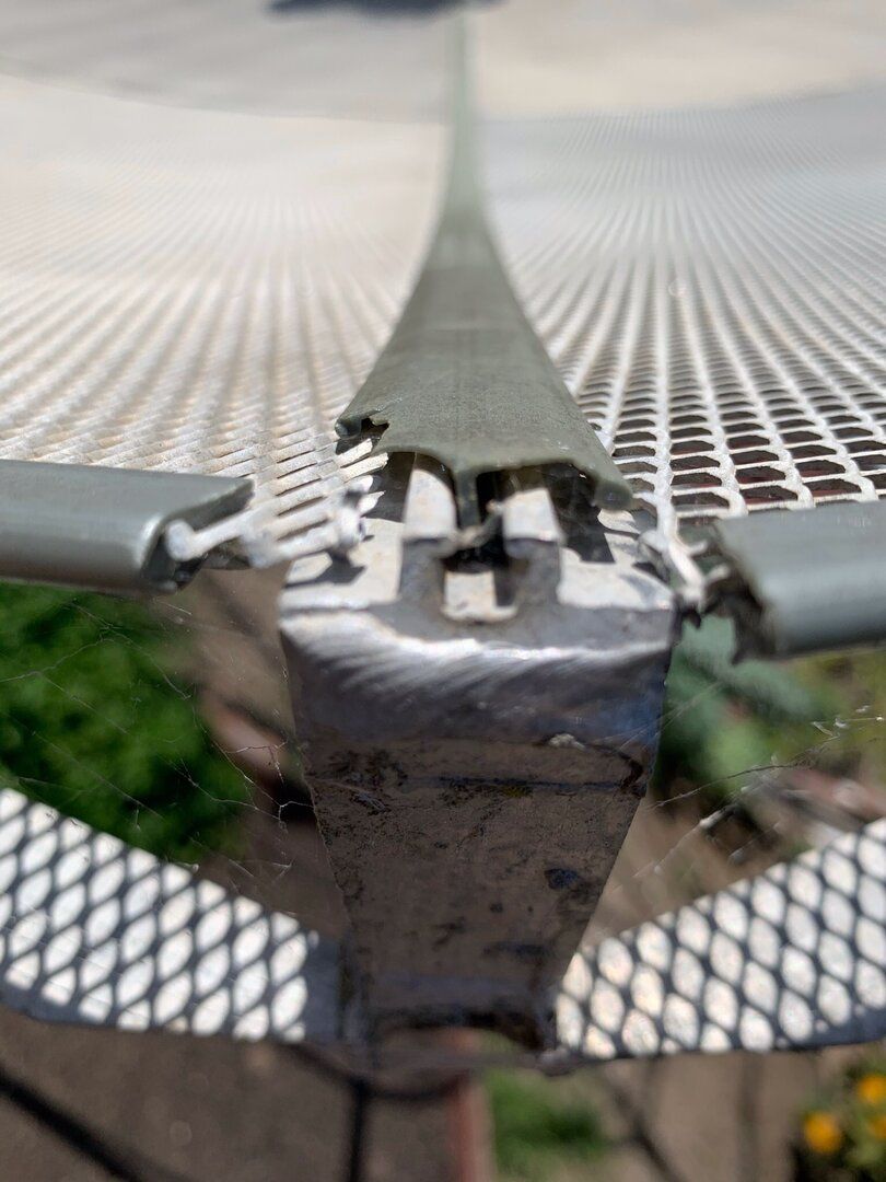

Does anyone know where I can get the plastic piece that slides in the channel on the rib of a Paraclipse that holds the mesh down? Is there something I can substitute?
Oh no. The others have more damage and are falling apart since they are so brittle. I only added the picture to show what the piece looks like and the channel it slides in. I took the dish down from the original owner about 15 years ago and they were starting to crack apart then. They only got worse.

Looks like you could find some thin aluminum strap. Drills holes down the middle and secure with rivets or screws to the center of the rib. Insert the panels and take a plastic mallet and bend the edges down to crimp the mesh in place.

How much would aluminum strips on top affect signal?
But then again... Lots of mesh/perforated dishes used metal track to hold the panels in place. Probably more of an issue on Ku, I guess.

Like 907tech commented, my Channel Master has aluminum channel to secure the mesh too. True, the surface is not as perfect as a spun aluminum dish but it still works well :)
In the 1980s I built a lot of 14 foot Golden Eagle antennas (made in Portland, OR area), and used lengths of 1-inch wide aluminum strip between mesh panels AFTER first installing mesh J clips for each panel. Found that predrilling appropriate holes about a foot apart on these strips, then using a sharp drill bit to complete a drilling through the square tube on the antenna (using strip as a template)...then installing 1/8 inch pop rivets to hold in place.
Much quicker than fighting with wire wrap between mesh panels, and plenty acceptable for C-band accuracy. The 12 foot Paraclipse should allow a similar installation after first removing the T-lock strips that are presently in place. This is very strong mechanical attaching method that will usually outlast any mesh, but as I said earlier, don't waste your time trying to pull Ku-band out of one of these antennas. Besides the mesh not being small enough you have the issue of not matching the parabolic curve across these wide panel surfaces. Orbitron got around it slightly by pre-forming their mesh, but it will be more trouble than it is worth with the antenna you are trying to use. Good luck!
