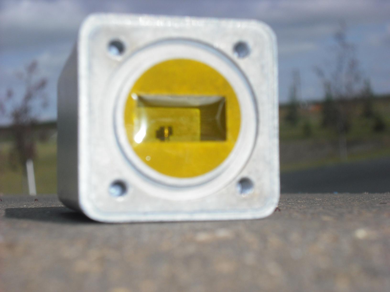

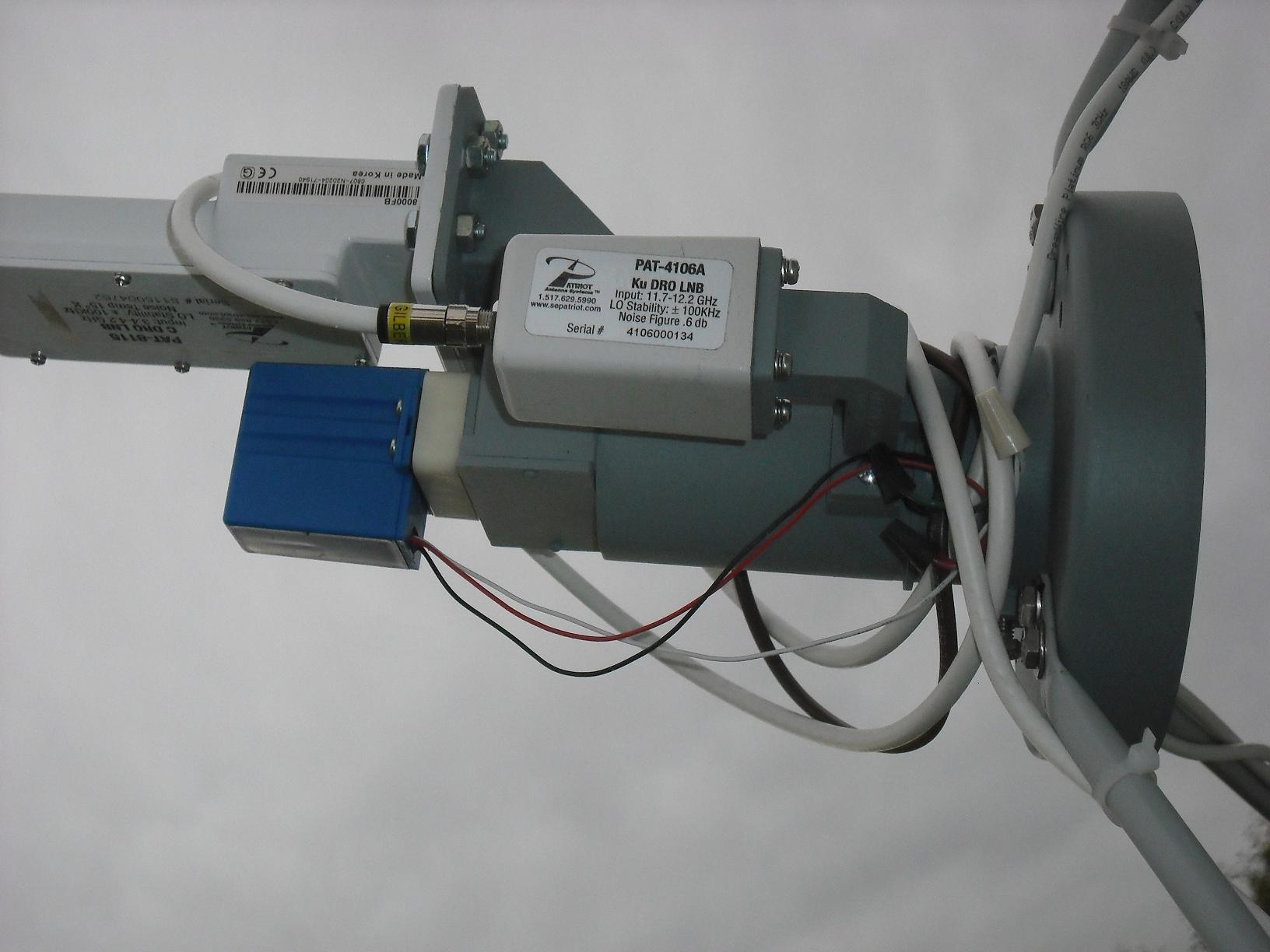

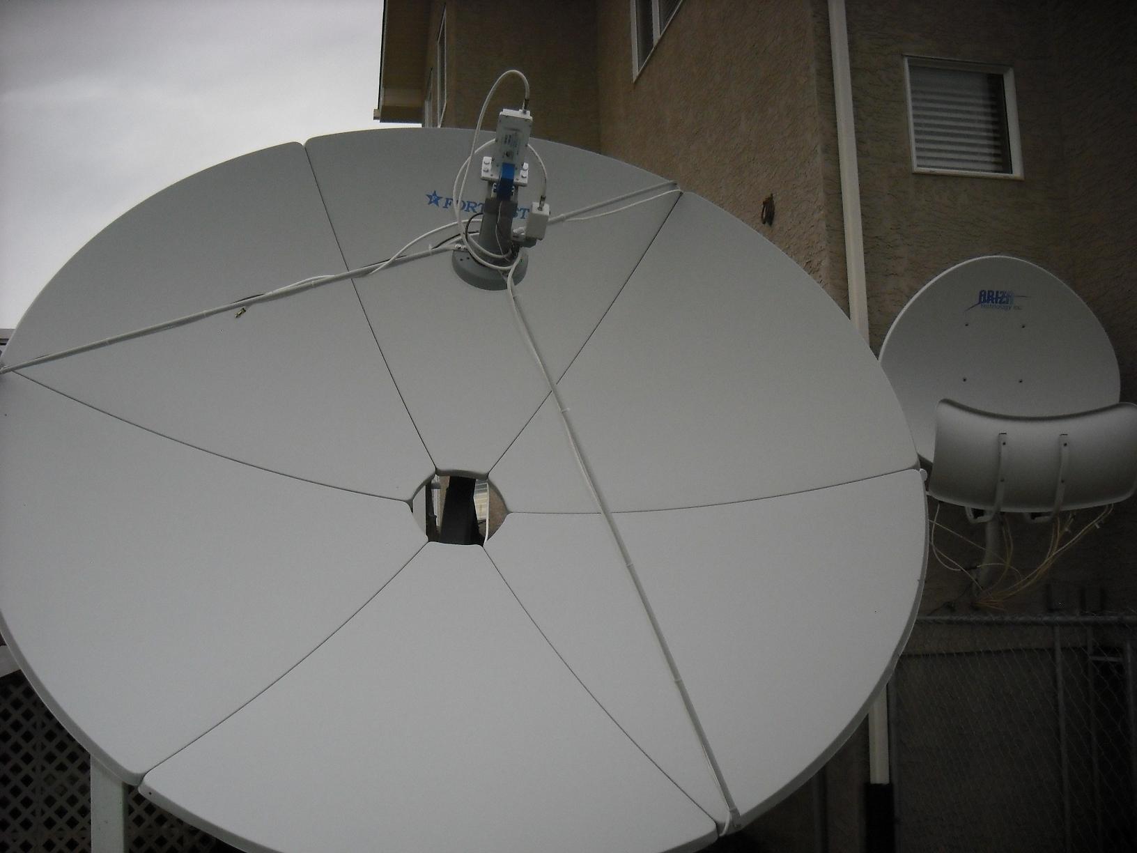

I installed a PAT 4106A as shown in pictures. Also refer to my set up at the bottom.
I am having a bit of a problem to set it up any help would be much appreciated
My questions:
1- Shall I take the yellow transparent paper cover shown in picture to install?
2- the cylinder inside LNB has to be located in any special direction?

leave clear protection plastic on.
one way gets H turn it 90 degrees and it gets V (the corotor will handle the changing)
Thanks Gabshere for your response ..This is the answer I got from a different forum:
I wouldn't recommend to remove the film (kapton tape ?) because of :
1st - it RF transparent
2nd - it prevent get moisture inside, hence help against corrosion or buildup some sulfurs
By PSmith
Here my findings:
Since I had two different opinions and I a already taken the plastic off and mounted I decided to measure signals with and without plastic. I chose Galaxy 17 :
NG-Dig 70%, Speed Dig 72%, Fuel-dig 71%, Soccer 71% and Nat Geo 71% Level with 80% Quality
And yes the values are exactly the same for both cases... So I decided to leave plastic on and suggest not taking it off as per post above from PSmith
