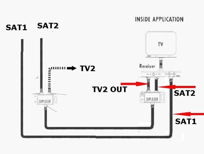

'40' is kind of low for good rain fade protection, a re-alignment and '60' would be better. Your 'No TV2' should work if you have modulator enabled and using correct channel. Because the installer gave you 2 coax feeds I doubt the receiving DISH is using
DishPro LNBF which you need to have, to be able to send sat1 and sat2 feeds down a single coax cable then a seperator is used to 'seperate' it back to sat1 and sat2 to feed the two inputs on the receiver.
Diplexer wiring guide.

nice to have a diagram.

It all depends if the equipment, if it is 'DishPro; or 'Legacy'.
With DishPro the two feeds are stacked (950 – 1450 MHz and 1450 – 2150MHz) and sent down a signal coax. Over the air TV range is 50 MHz to 850MHz, the same frequency range that TV2 uses to back-feed from vip222 to TV2. So you can see all 3 signals can co-exist on a single coax.
With enough diplexers you could run these in addition but not recommended to back-feed TV2 out with an external antenna VHF/UHF because you will be broadcasting TV2 out to the neighborhood, just make sure the TV2 out channel you pick are
not being used.
1- TV2 back-feed from vip222.
2- External back-feed Remote 2 UHF atenna.
3- VHF/UHF external antenna feed to vip22
With 'Legacy' you'll have two 950 – 1450 MHz feeds and there is no easy way to combine and send down single coax.
Hope this helps
