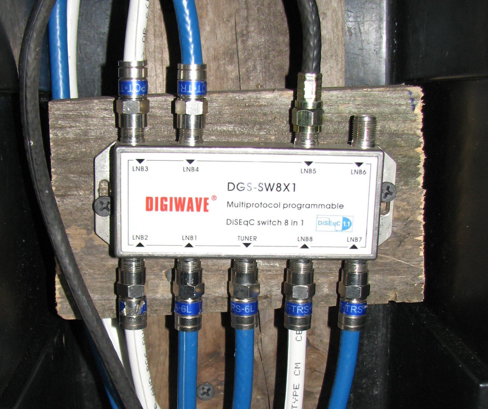

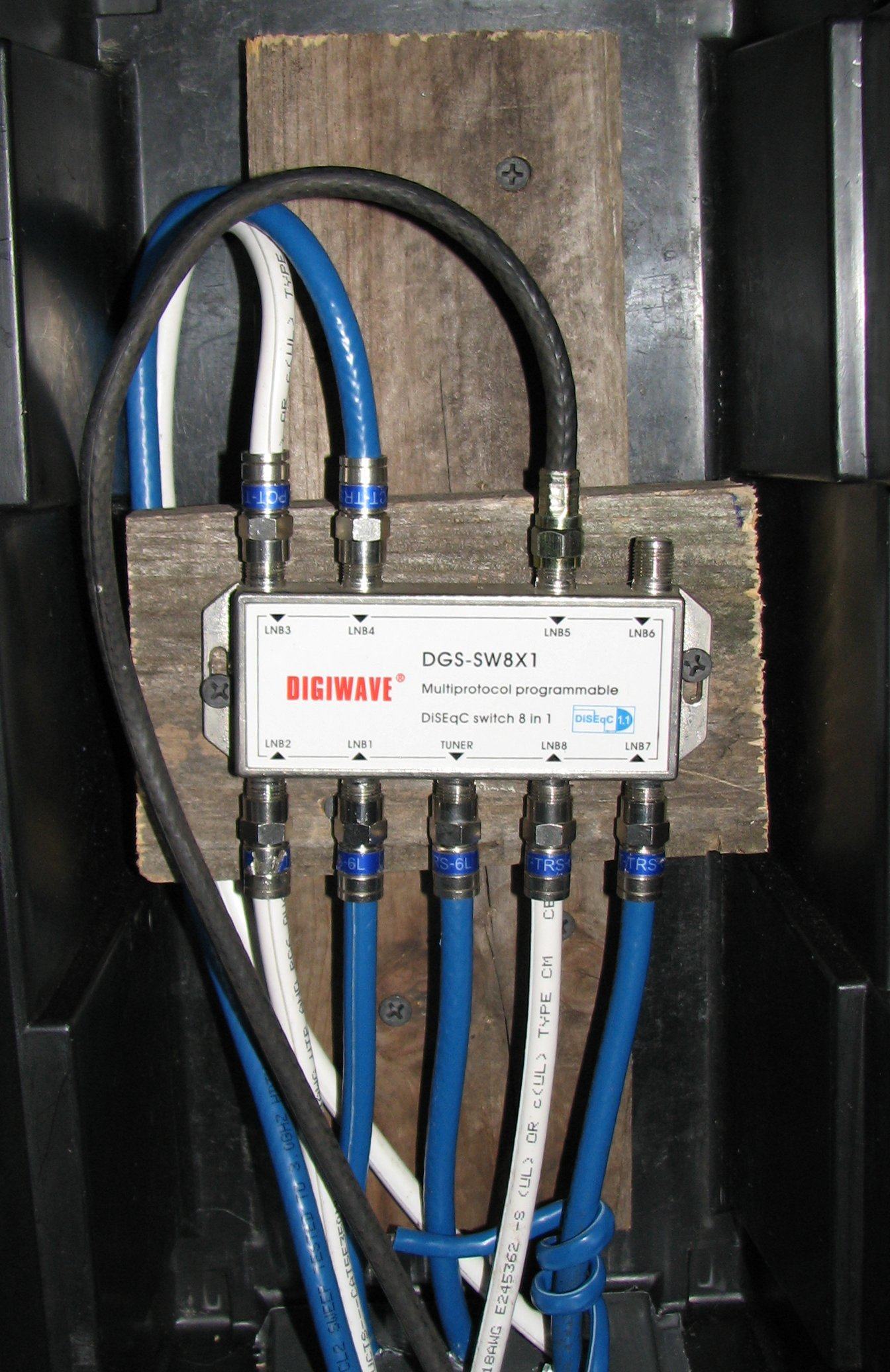

~This~ is the switch I have. It apparently is an "DIGIWAVE DGS-SW*X1"..
I found it on ebay last year for about $20 I think. I checked and they are still selling these a-plenty on ebay for about $20 through various sellers.
I'm thinking that when I get ahead a little I might do well to buy a second one as a spare just in case I ruin this one, I see you guys giving warnings all the time about how easy it is to mess them up. And knowing my luck, I would ruin mine then find out they don't make them anymore. :(
It's always a good idea to have a spare of anything that is important to you. :)
