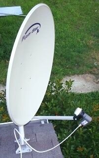

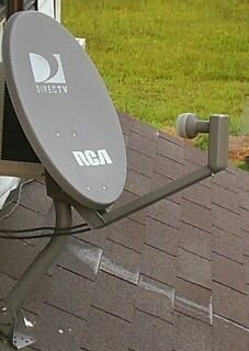

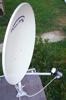

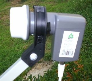

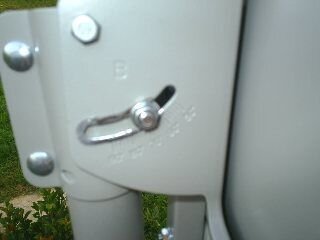

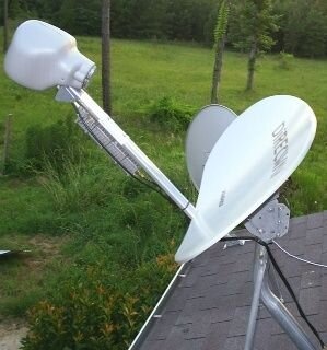

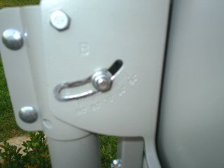

this is a few pic's of my fta 31" gem star and my internet direcway dish and may dierctv dish my direc stuff works fine i tuned the t.v sat but i could not tune the internet sat i had to have direc come out and do it

Offhand, the first thing I see is that the FTA dish seems to be aiming rather downward, unless it's just the camera angle. The DirecWay dish is WAY up, the DTV dish is angled upward, and the FTA dish is looking for squirels in the yard :D Again, could be camera angles, but my "eye-clometer" says it should be sitting back on its haunches by at least 20 degrees more.
the dicrecway dish is very picky and that is the only way it works i have very high signal on it and that is what i am on the interent right now with . and the tv works fine both have worked fine for over a year . the fta dish is down i know but i can not pick a signal up any other way do you think it is where it is mounted at i can swing it all around and pick sats up left and right but not any higher ?
should i put the fta on a pole in the yard ? or should it be fine where it is ? if i swing to much more towards the house i guess i will block the signal ? although when pointed at the house the meter is off the chart i dont know if this is a false reading or what :confused:
