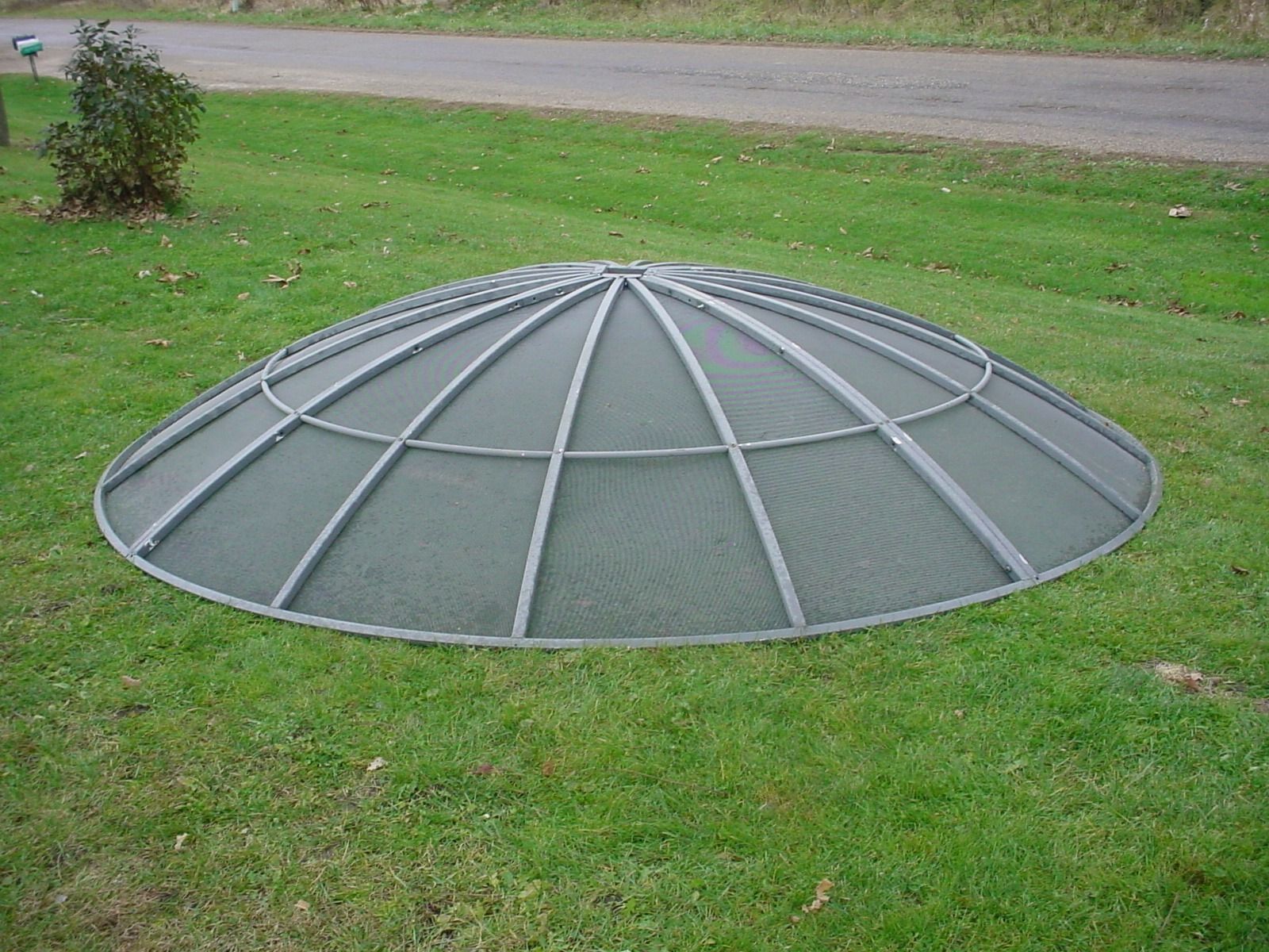

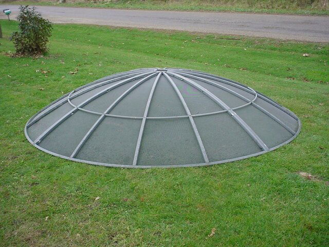

cadsulfide had a dish for me.. but i was at an auction today and couldnt say no for $7.50! its a perfect 10 10 foot dish with a h-h motor (no cover so i cant confirm its an ajak) the mesh has holes in it but they can be fixed (line the whole thing with foil!)
but cadsulfide said i could have his dish for the shipping. if his dish is the same mounting as mine i might take it. which one should i keep?

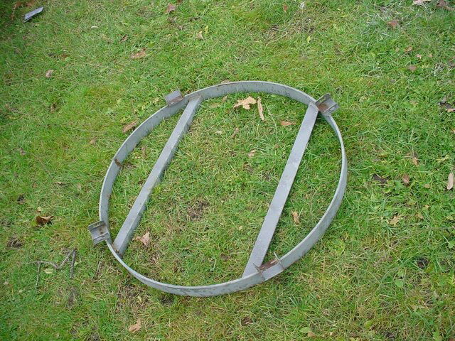

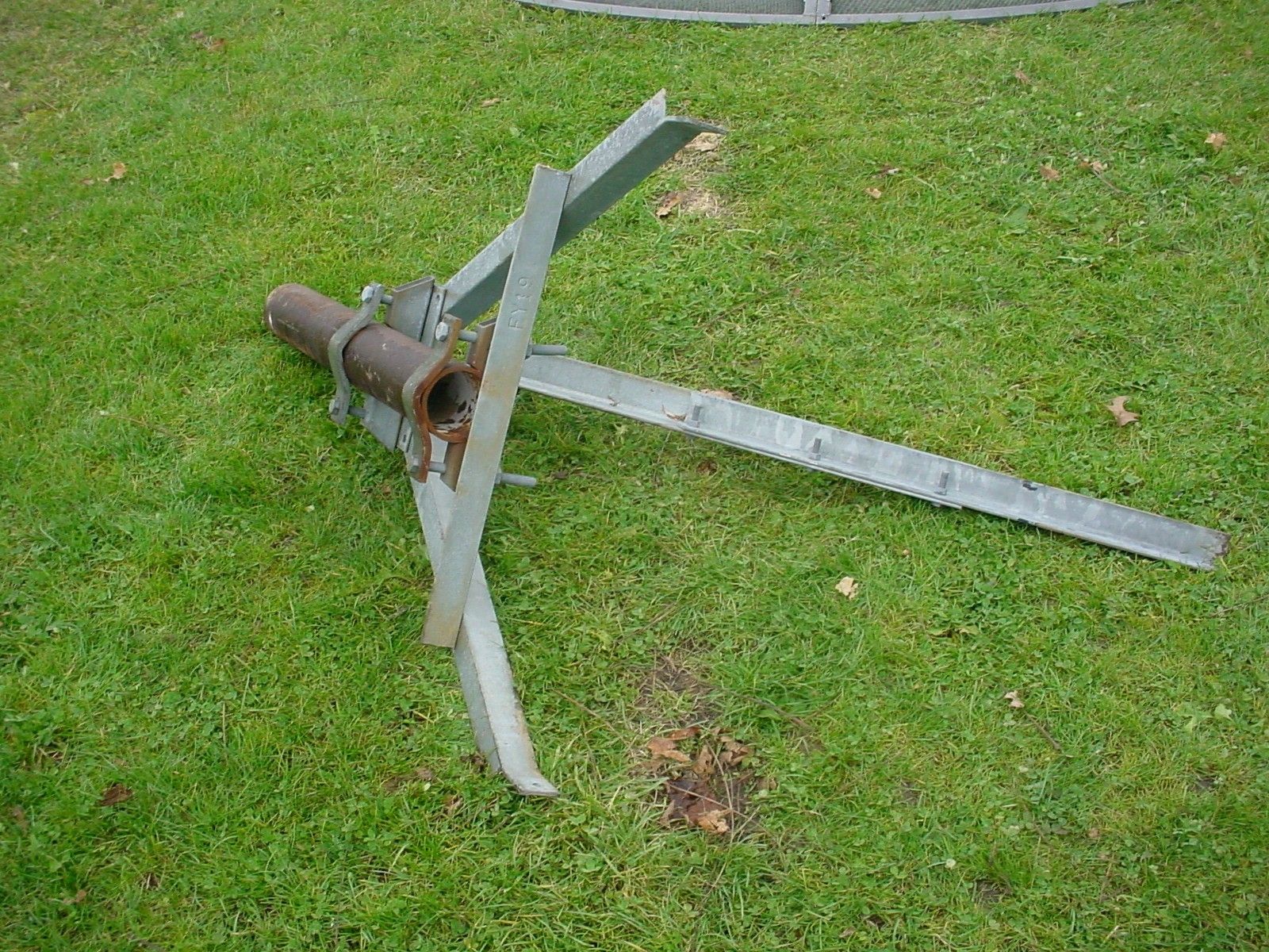

if cadsulfide's dish is the same il junk the refelctor and use his. I made a button hook out of emt conduit but i didnt get much (nothing to be honest). if cad's dish is diffrent the mesh screws on so i might use some guttar guard or some aluminum foil and screw it on. what is that frame thing in the 3rd pic? i looked at everything and cant figure out what that does!
I would run that dish the way it is, the Perfect-10 are a good playing dish, would run that dish with its quad leg design over a button hook dish any day.

Get it up and see how it performs, you will probably be surprised. Minor dings and cuts won't hurt you much. If you decide to paint first, mark where the settinge were beforehand for a good starting point. I also agree with the Captain about the legs, keep 'em.
That Ajax looks to be built like a tank. Nice find!.

mess on perfect-10's are A-ok no need to change it, an a ripe or a hole is easy to fix, unless a hole pannel is riped out, then unscrew it an put new 1 in, but beleive me to reskin a dish, is very time consuming, I have done a few. now the picture of that dish, the mess looks great, don't see no ripes or tears in the picture.

1captain: if you have any pie panels can you just give me the mesh? i think one panel is ok. what is that thing in the 3rd pic??!?!

im not sure looks to small to clear the dish off the ground. do the ajaks move quicker?
i searched sat guys for ajak and found a pic of a dish with an akak AND and acuator maybee that what the frame was for?
That's a motorized elevation adjustment, which may have been used as a poor man's way to track inclined orbit satellites. Lazy people have been known to use them when they have done a poor job of tracking the arc. Needs some motor drive cable and a separate positioner box. Or just slide in place wherever the elevation angle needs to be for your location. Probably stronger than many elevation adjusters.

like i said thats what the frame might have been for but looking at everything it doesnt fit on the dish so maybe it was some sort of tripod mount.
With the clamps an blocks that are holding the pipe to the mount, that was made by Roan, that was their style. looks to be a peak of a roof mount with a side support bar.

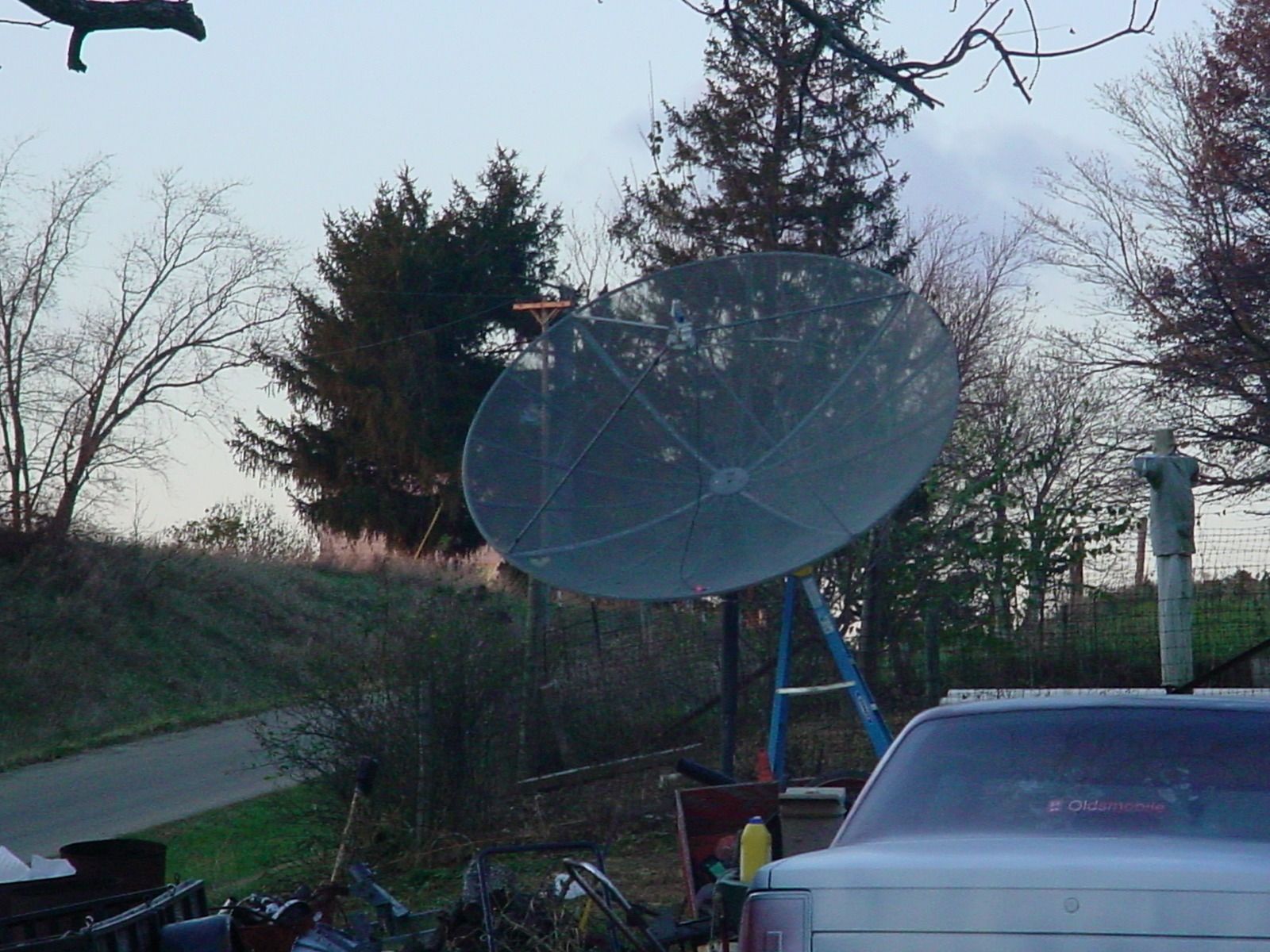

got er up today! (pix below) anyway got some questions
the feedhorn is centred acording to the lnb arms but when i put a rod through the center hole of the dish its about 3 inches off yet my quailty on channels is 92%
1. should i mess with the feedhorn?
2. how do you alighn a h-h mount? on a pizza dish you point the dish on true-south sat with the motor at 0'
