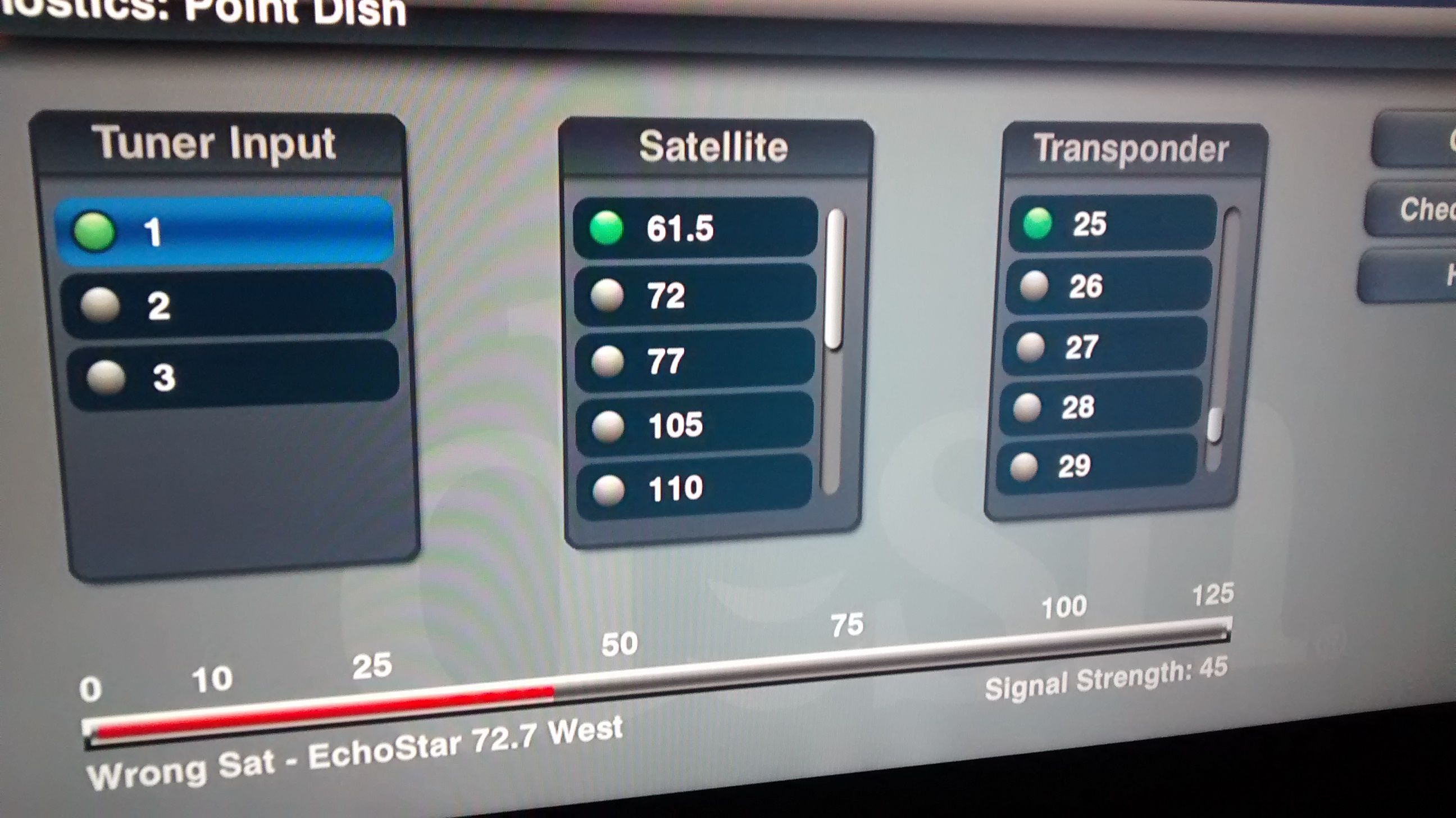

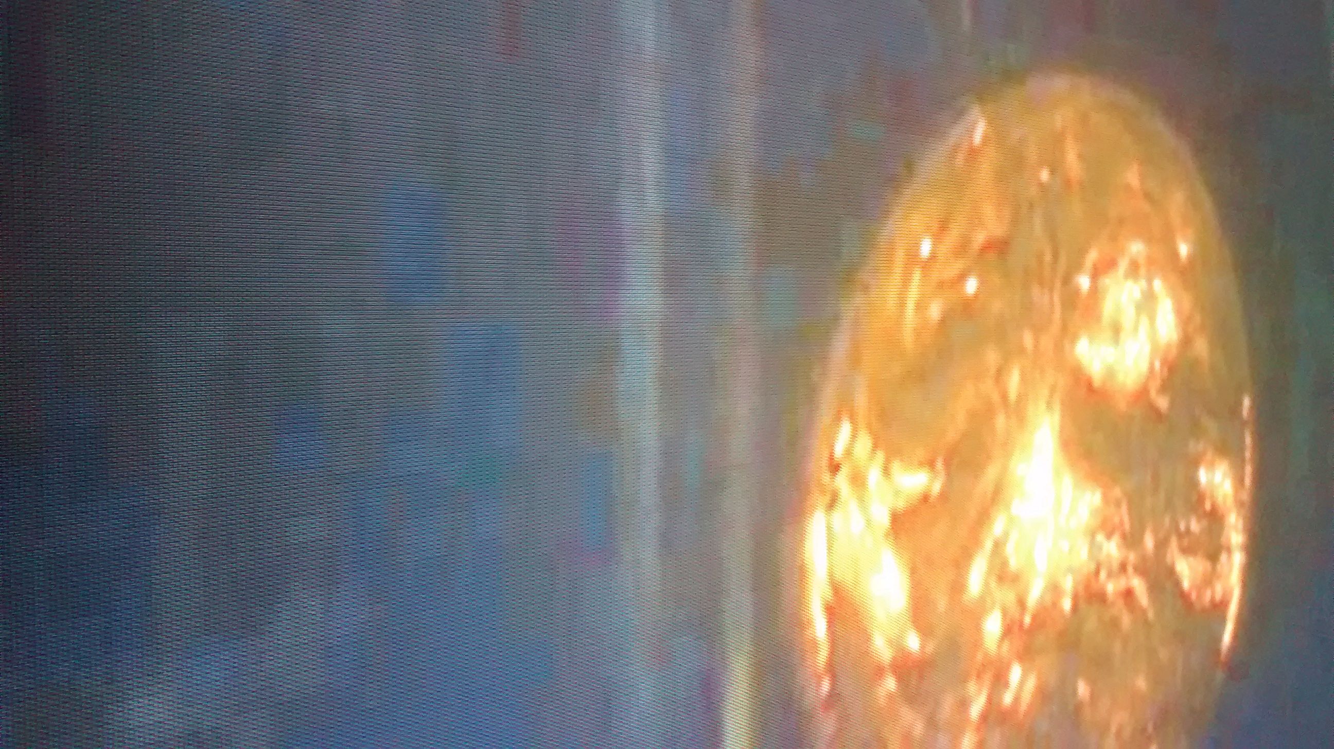

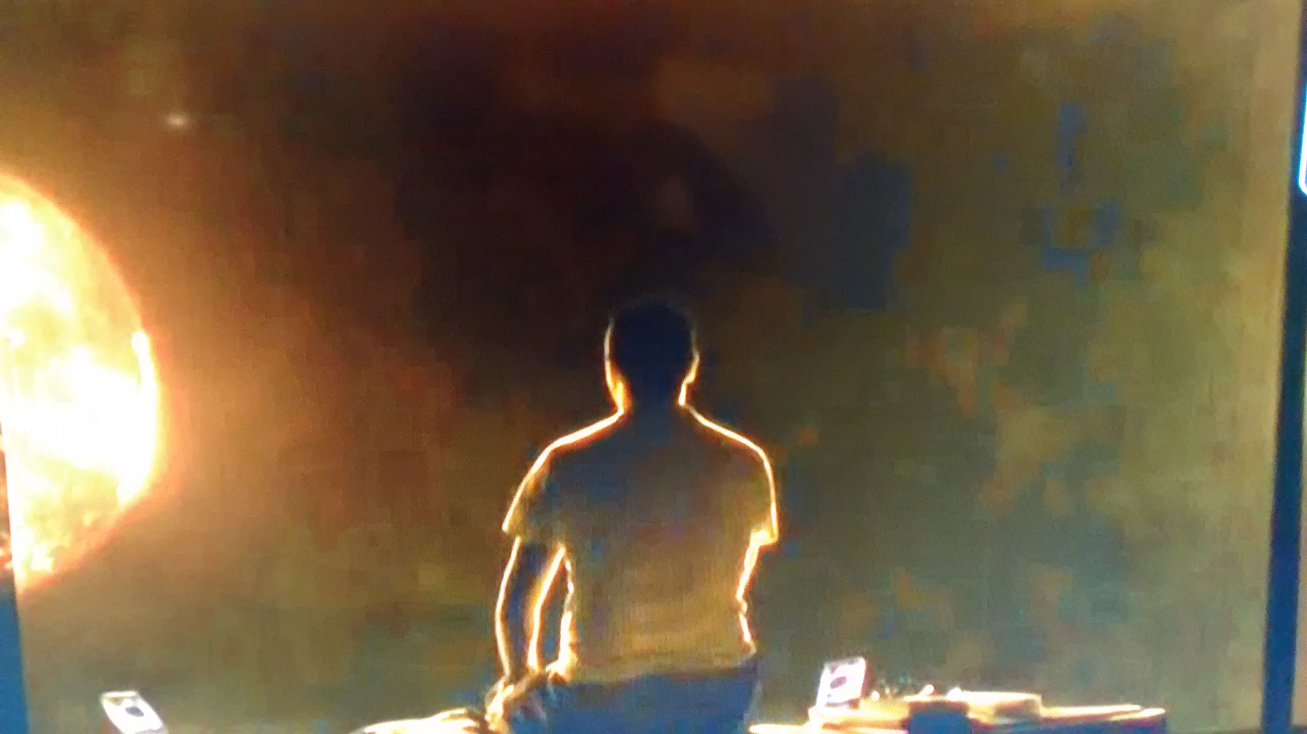

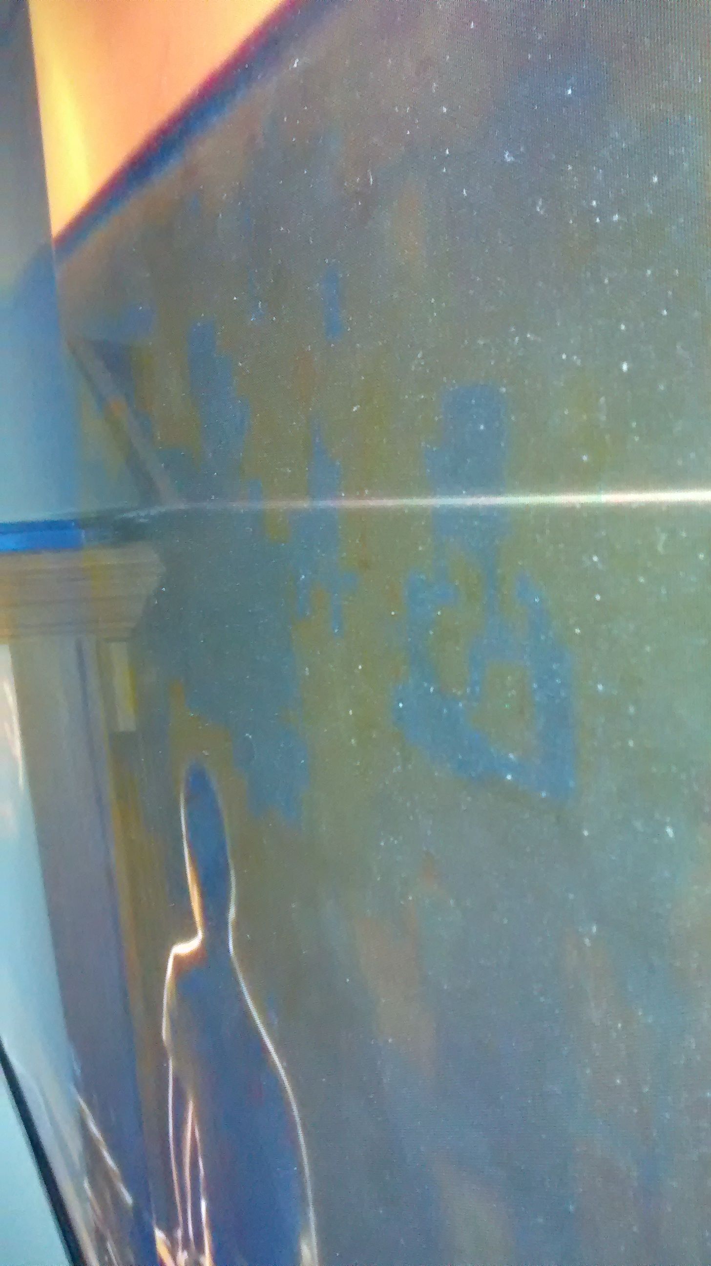

Pixelation usually means low or partially blocked signal. Can you take a picture and post it here of the pixelation? Also, what dish are you using? Western or eastern arc?
Here some pics

It is not locking on the 61.5 LNB. May be a bad LNB, bad Node, bad Cable, or even bad Hopper at that point. It also could be misaligned although that is not my first guess. That would explain your issue though. You need a technician.
