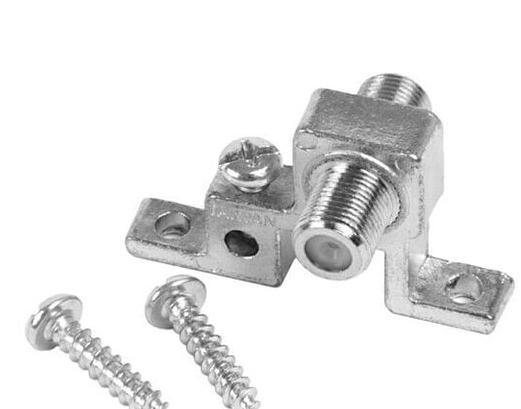

The antenna is but the actual RG-6 isn't. I would have to cut the line between the preamp and the power supply and put a ground block inline. Is that what you are suggesting?
I used one of these:
Then ran a piece of copper from that little junction on the side to a water pipe. I'm not sure which line you're talking about "cutting". My antenna is in the attic, and I had a homerun to my distro panel.
