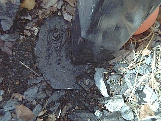

If you can borrow a hammer drill with a large enough drill into the rock. You could use threaded rod with anchoring cement and use heavy plate steel base. I have an old miller welder that helped cut the half inch plate steel in this picture.
or smaller hammer drill with screw anchors?

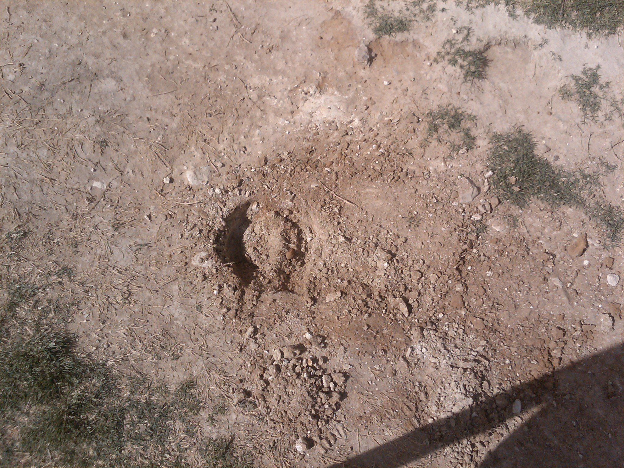

here is a pic of the area
That is a tough peace of ground, in my younger days I would have tackled it.
I used to fill the whole with water wait until it softens it then I would use a heavy 5 ft iron bar with a point on one end to help break it up. Then dig out the loosened dirt with a post hole digger repeat until deep enough. It could take days doing it that way!
Easier to align-sure. If you know you have a good solid pipe that's plumb and not going to sway in the wind, should be easier. I have ground nearly that bad, if I can get over 18" down, it's like GaryZ said, takes a railroad bar and a lot of pounding, but man, when you get a pipe in that with a little concrete, its THERE!
