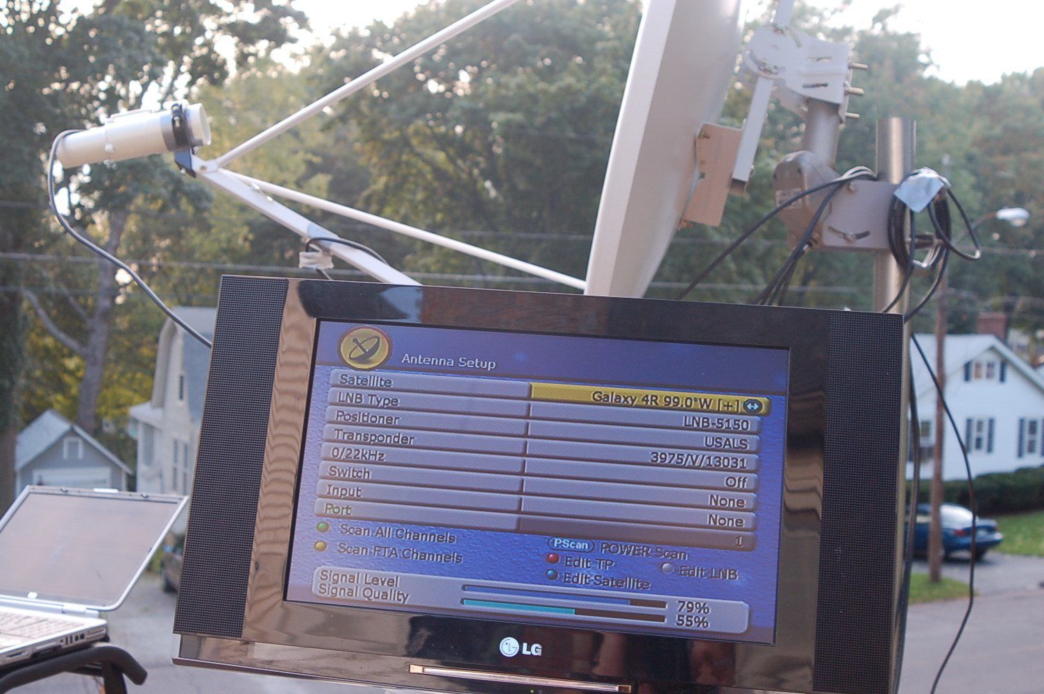

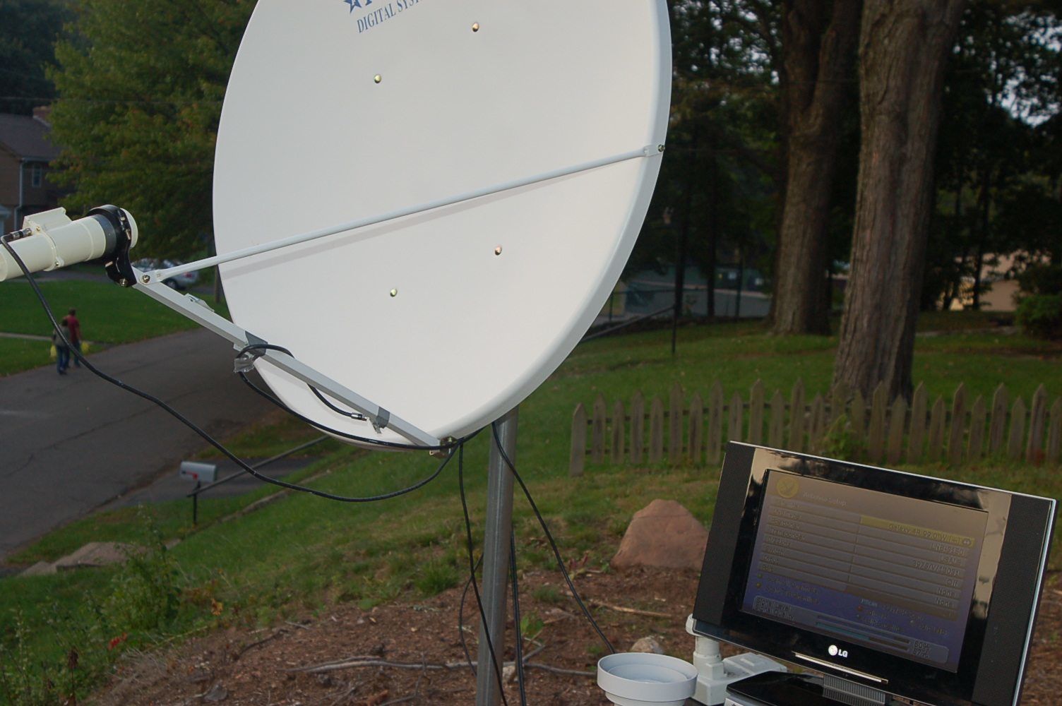

Ok today I went outside after the rain stopped any played with my dish for 3 hours. There was a few things I wanted to try today including playing with the new Bsc621-2 C/ku Lnbf that MrTim sent me, and testing out one of the LNBs from Sadoun gave to everyone who attended our party last week.
The first thing I did was locked my dish and peeked the signal on a channel. The LNB I have been using on this dish is an Invacom Quad Polar. This is a LNB I really love. I figured I would try one of the LNB's Sadoun gave out last week. I expected it was a cheap LNB... Boy was I wrong! I peeked the dish for the strongest signal I could get on SBS 6 with the Invacom LNB I had a 67% signal level and a signal quality of 59%
I took off the Invacom LNB and replaced it with the Sadoun KUL1 LNB, my signal level jumped up to 72% and my signal quality jumped to 66%. This was a VERY surprising result!
I scanned the skies and was now easily pulling in signals that I had trouble with in the past including the Late Dr Gene Scott on the University Network. I must say this LNB really suprised me! (And just think if you were at our party last week you got one of these for FREE from Sadoun!)
I then popped on the C / KU Band LNB that the folks from SatelliteAV sent me a few monthss ago. I immediately got a signal reading at around (allthough slightly lower) then the Invacom LNB on KU.
Since I already had the LNB on the mount I wanted to see if I could get anything from C Band. For some reason the first satellite I selected was G4R, the dish moved over and nothing. I then grabbed the LNB and turned it a bit. BOOM I had signal! I did a powerscan on my Fortec Mercury II receiver and when it found 3 transponders I canceled out so I could tighten things down by hand. However it managed to scan in some channels... A football Game, The WB Network HD and some other strange scrambled channels.

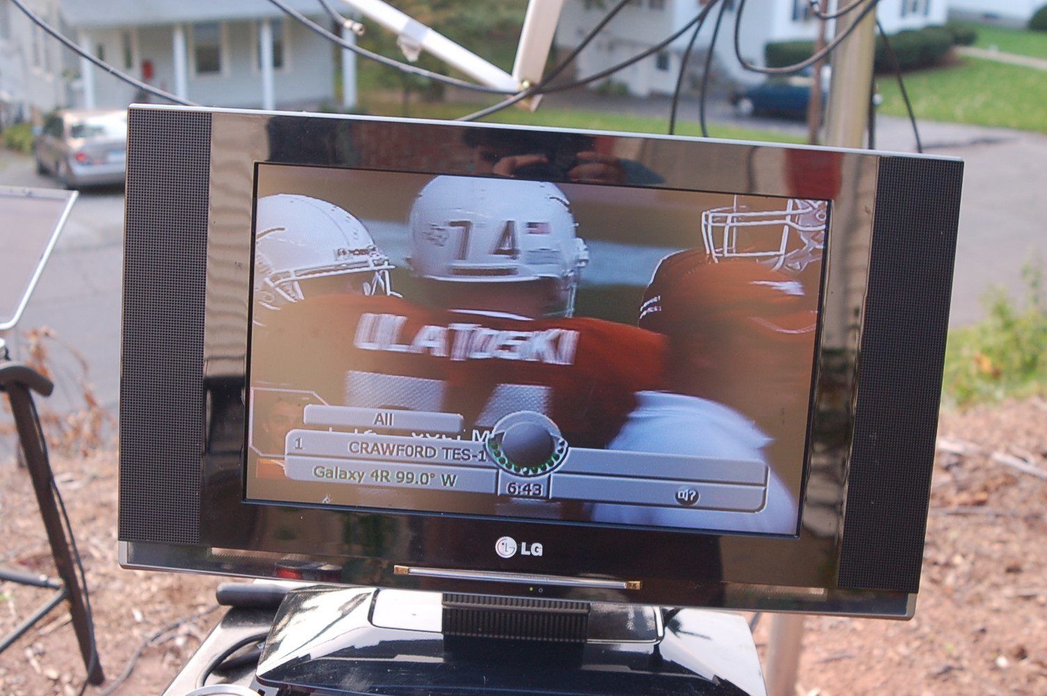

My first picture I saw was
Iowa State - VS - Texas
G4R 3975/V/13031
Video PID 308
Audio PID 256
PCR SID 8190
SID 1
Scaned in as Crawford TES-16

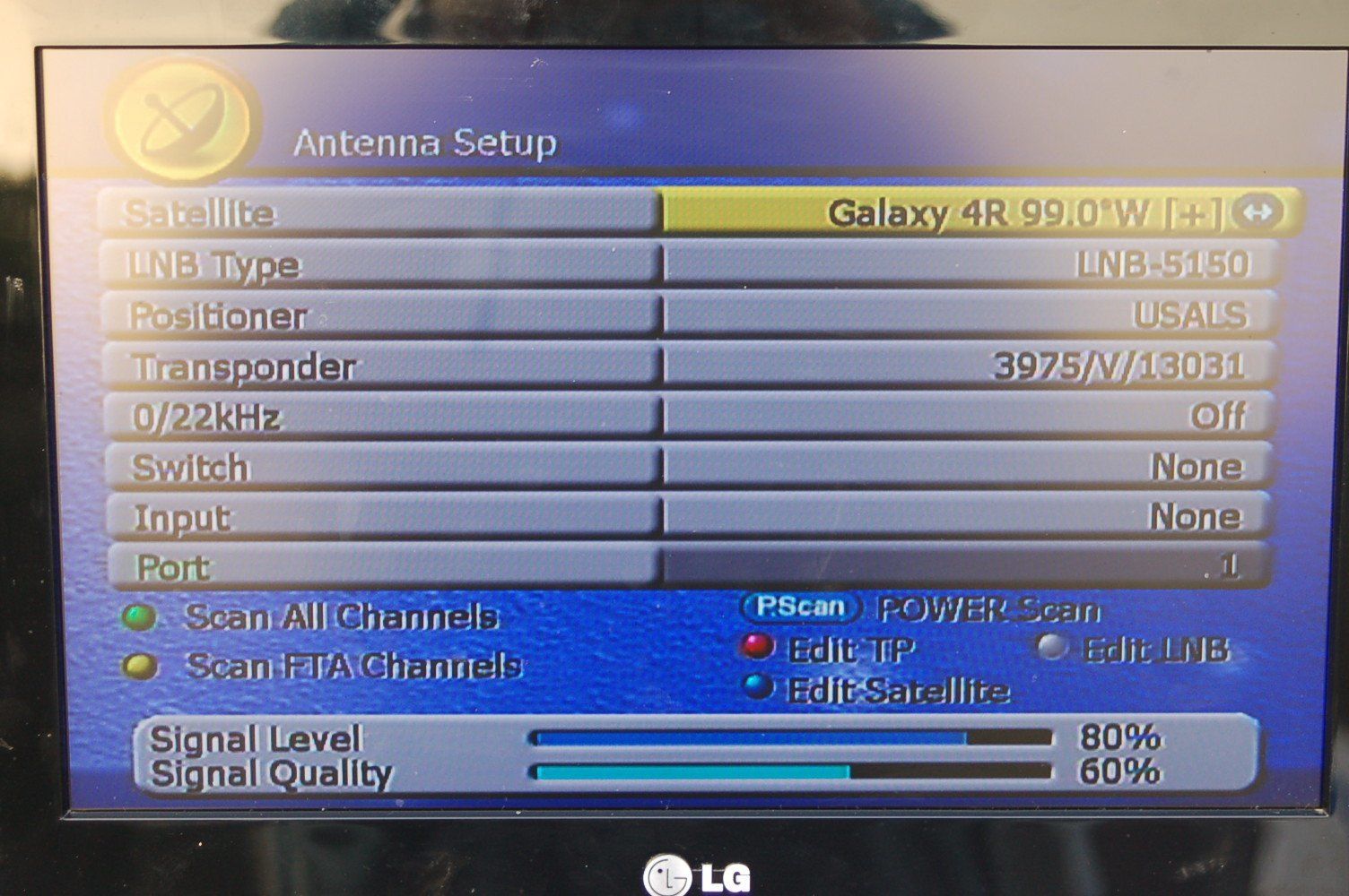

It was BOOMING in with a 77% signal level and a 58% signal quality. I was happy!
I went to tighten things down and in doing so I knocked the scaller ring off the LNB and on to the ground, when I did this my signal readings went UP!
I thought it was impossible to pick up C Band Signals without the scaller ring. Boy was I wrong. :) Just to show I am not making this up I ran in the house and got my camera and took some pictures. In these pictures you can see the screen and the dish without the scaller ring.
I took some pictures and then put the scaller ring on. I was getting about the same signal reading with it on.
I then went back to check my KU but unfortunately it was all gone. I went back to C band and it was booming again on G4R, I then went to other C Band Satellites however I was never able to find another signal.

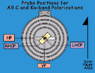

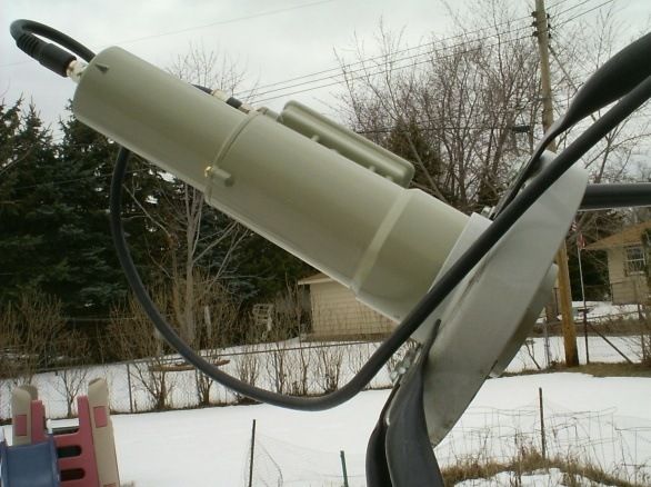

Make sure to have the skew mark on the BSC621-2 at 9 o'clock (standing in front of dish)
Sounds like a fun day! Welcome back to C-Band you have certainly opened up a LOAD more channels now!
Added a picture of the BSC621-2 with the skew mark at 3 o'clock, it should actually be at 9 o'clock.

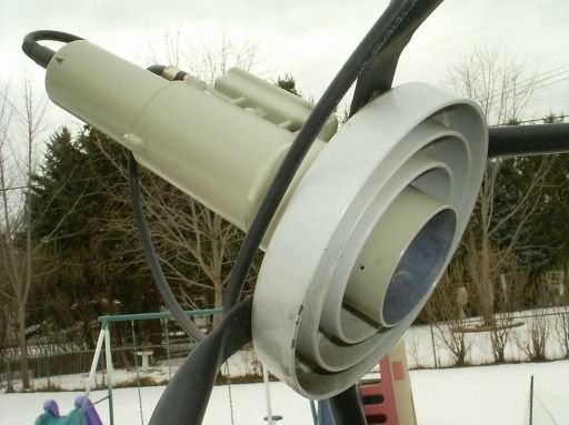

Sure you will get signals without the scalar, but my signals have always got worse when I removed it!

Scott I know on my ASC421 C-band LNB I had to skew at 9:00 and go from there

The scalar ring you were using probably was picking up background noise and reducing the amount of usable signal to your receiver, especially on an offset antenna using a ring designed for a prime focus antenna. The best scalar ring is one designed for the dish its being used on. The ring not only concentrates the satellite signal toward the feedhorn but also should be designed to block out the background signal from the edges of the dish and outward. Without the ring, your signal quality probably increased because you weren't picking up any background noise in your signal. Remember, the LNB you're using has its own little conical shaped feedhorn helping to concentrate the signals.
Are you sure about 9 o'clock? Maybe that's the case for prime focus dish, but for me on offset dish only 12 or 6 o'clock produce acceptable results.
Yes I am sure, 9 o'clock. The type of dish you are using does not affect the angle that the satellite signal comes down at!
I am using the BSC-621-2 Universal Ku, and 5150 C band LNBF, and I must have it at 12:00 o'clock or 6:00 clock (up or down) not 9:00 or 3:00 (left or right) to get signals.
My result is the same as VJ9999 has stated.
Offset 1.2m fortec dish.
Have a look below! If it works don't fix it :)

I went out there and took off the Sadoun LNB and put on the BSC LNB from MrTim. I did like pete said and set the mark to 9 O clock and nothing. I then set it to noon and had KU Signals. Guess some of the LNB's are marked diffrently.

We kept on having these mini showers so I had to keep unplugging my equipment and LCD TV and running it into the house and waiting for the rain to stop.
I couldnt come to a happy medium where I could see KU and C Band. The winds started to pick up and the skyes turned black. I decided to take off the BSC again and go back to the Sadoun LNB. Got it all setup and got my equipment in the house before we got a heavy downpour.
I reset my Fortec Mercury II receiver and loaded each satellite by doing a powerscan. I am surprised I can pick up the HORIZONS 1 satellite at 127 from Connecticut. I scan in a bunch of channels however none come in, and they are not labeled as being scrambled. Very strange. :)
Anyways I did a powerscan on all the satellites from AMC6 all the way over to Horizons 1 and am happy with the results. :)
I think the only way I will get C and KU to work is if someone makes a holder for my 1.2 meter dish which folks a standard KU LNB and one of the bigger C/KU band LNB's this way I can adjust each LNB accordingly. :)
