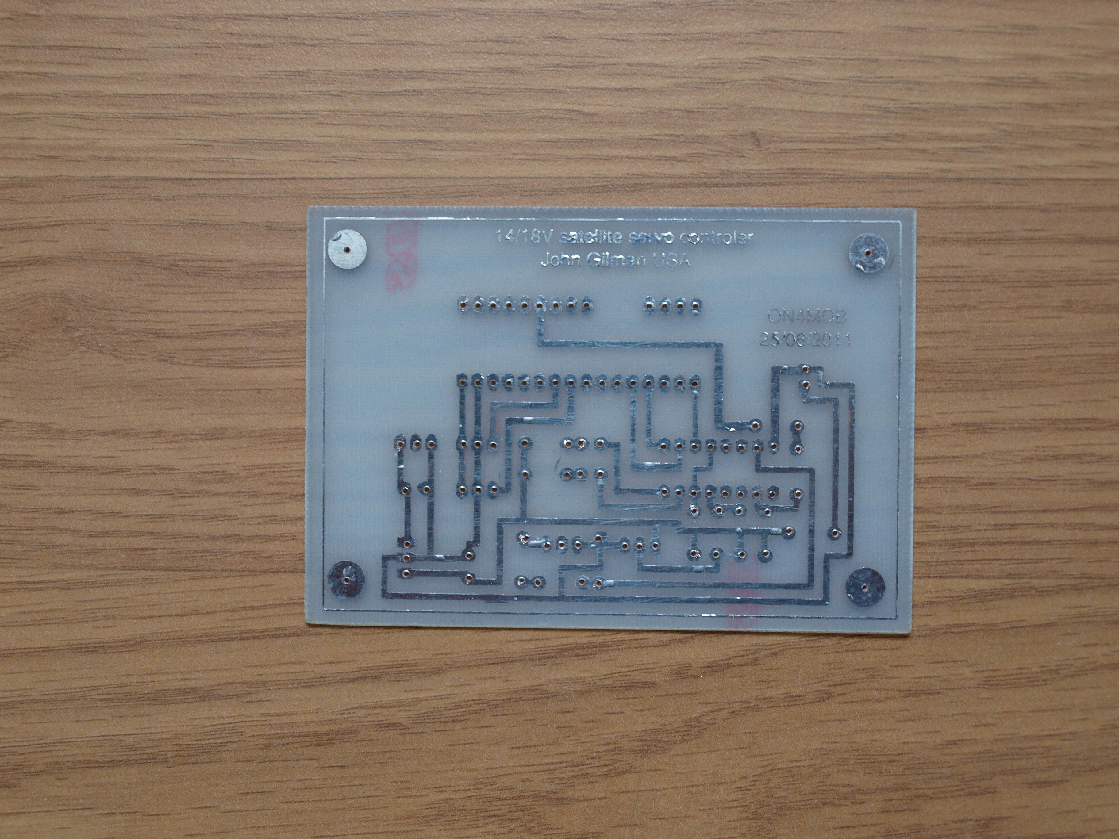

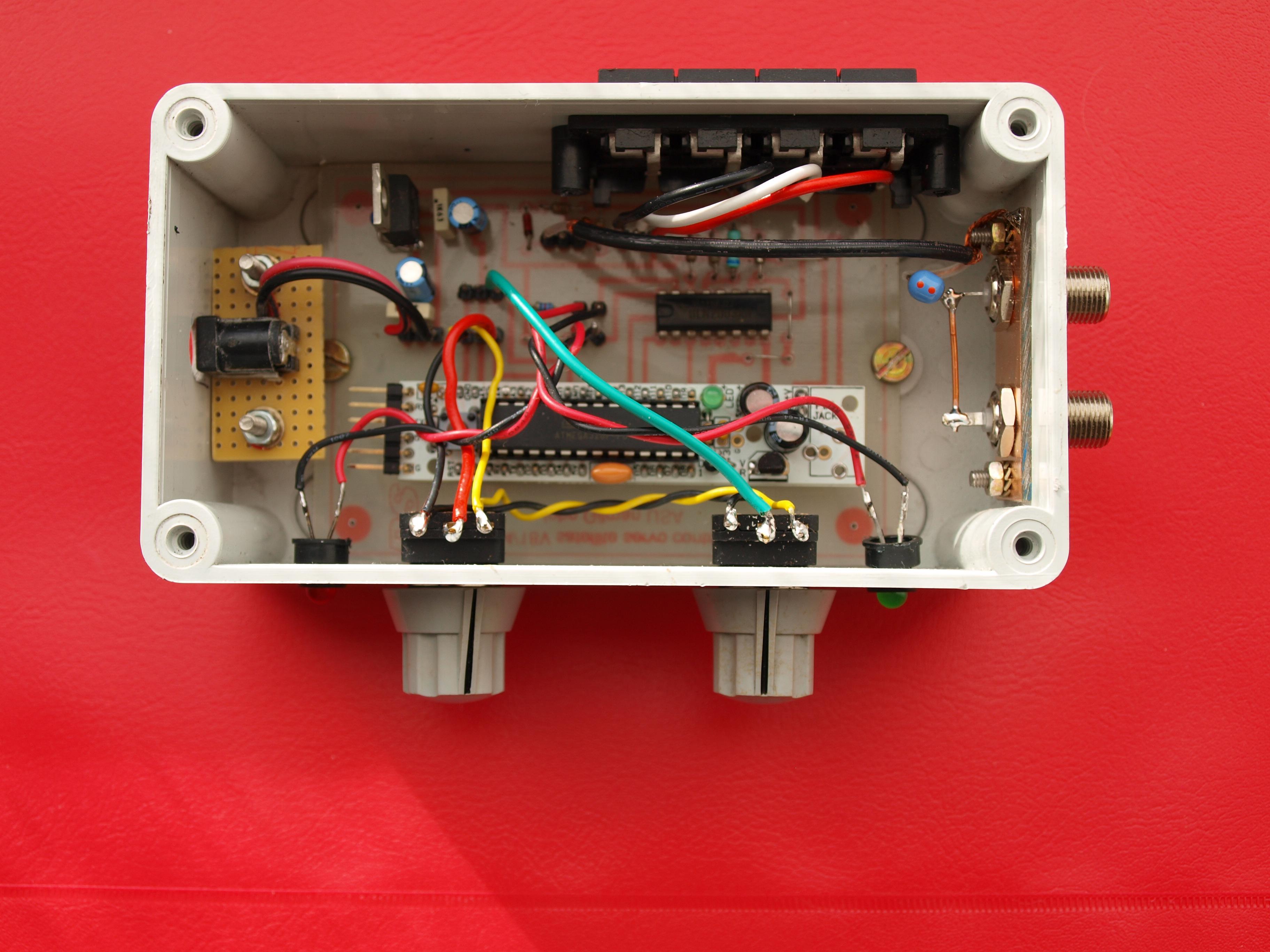

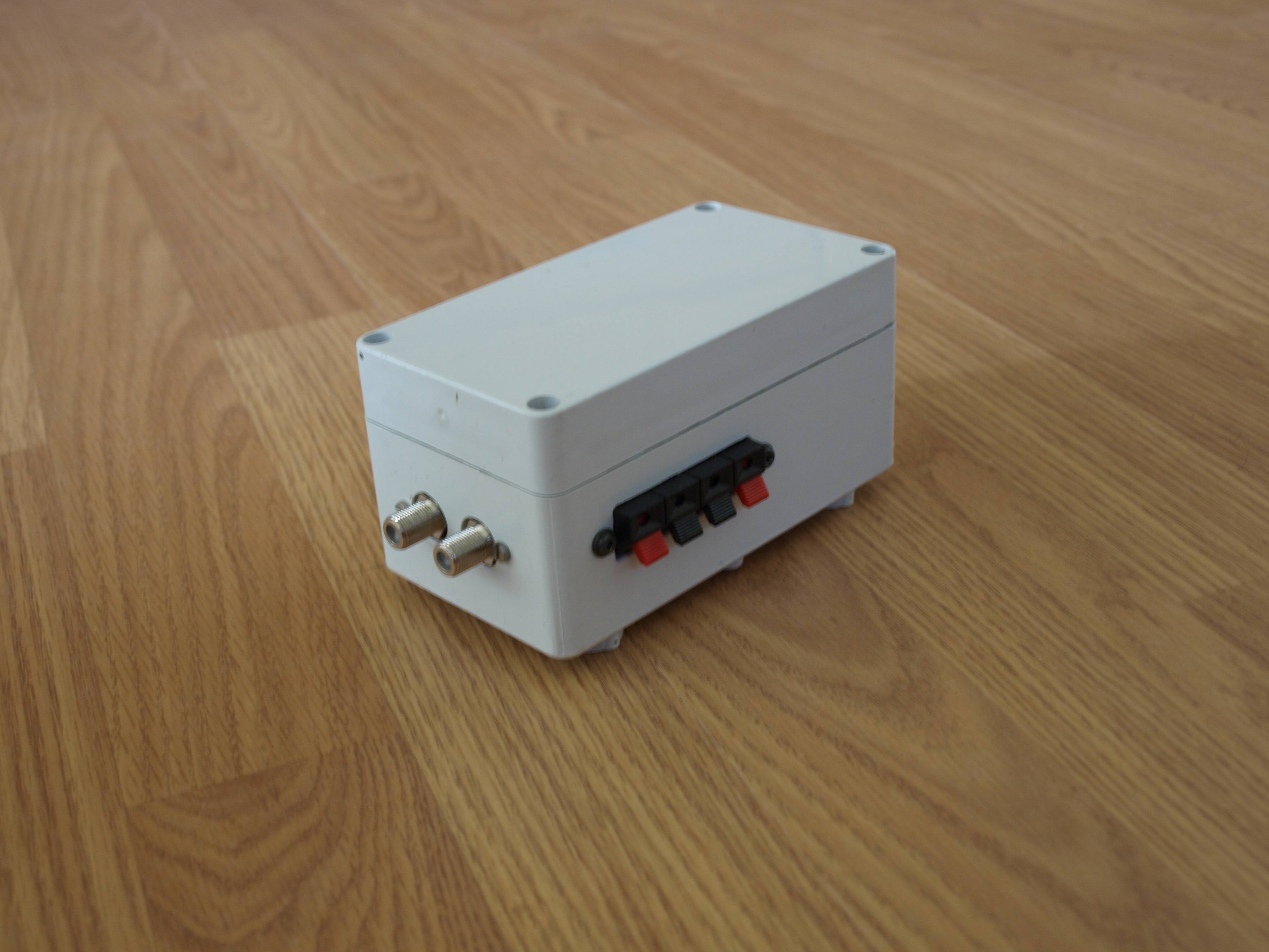

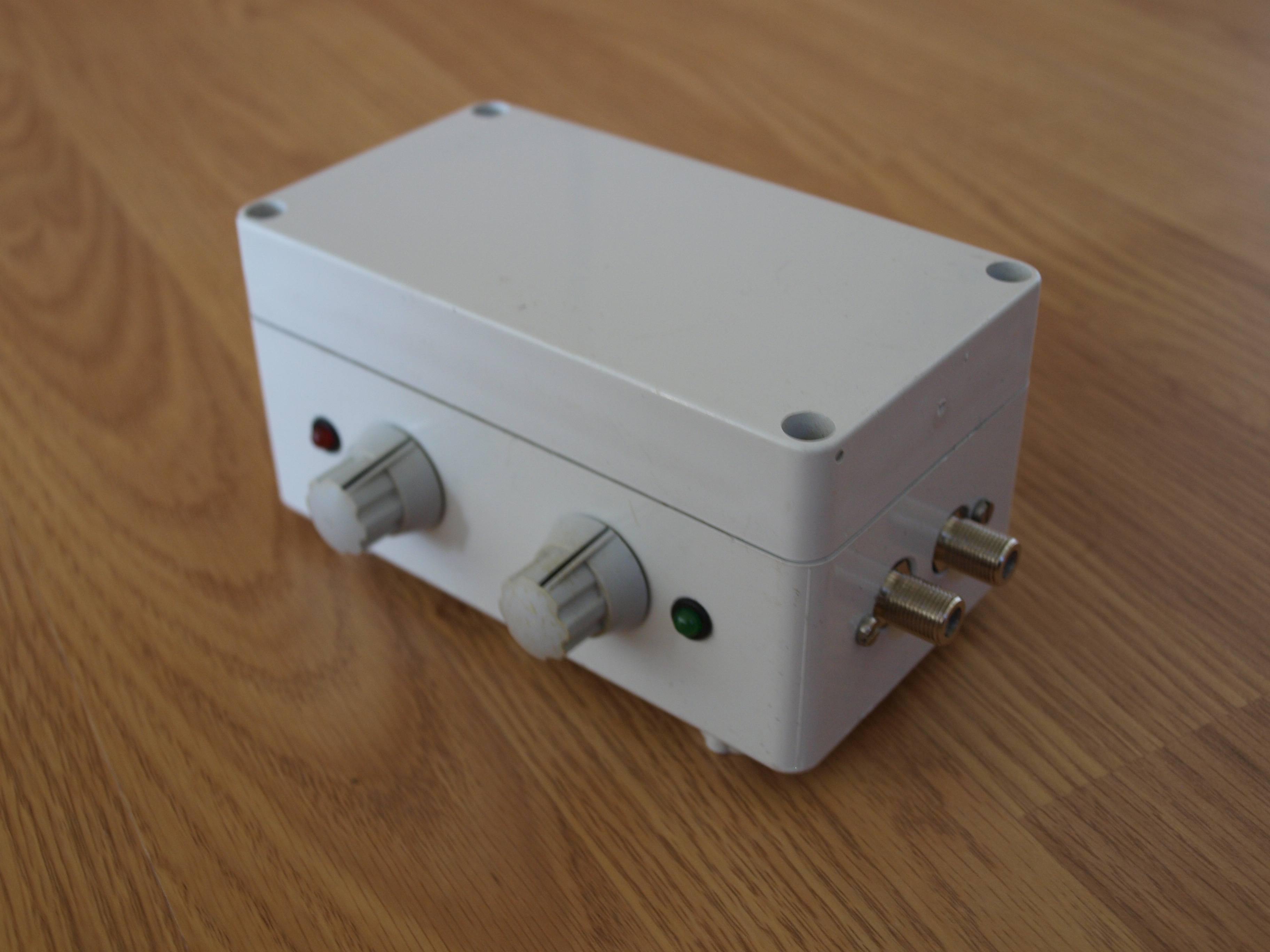

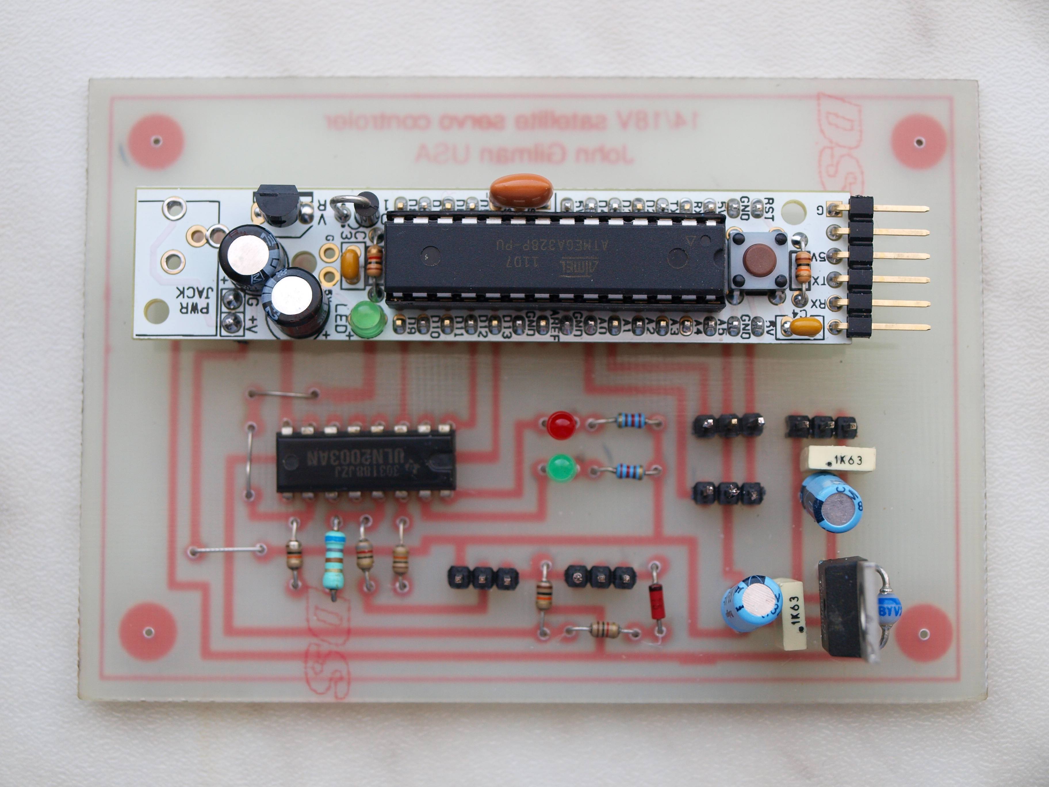

hello;
I have built the servo controller from John Gilman . Works fine in test conditions. I hope he does well even when my c-band dish is placed. Here some pictures. Greetings from Belgium Marc.

hello;
View attachment 67274View attachment 67275View attachment 67276View attachment 67277View attachment 67278
Where did you find the plans for that? I've been looking but not coming up with anything close.
Here the scan. The quality could be better. Before placing the components look at the picture. The additional components near the 7805 (2x 100nF - diode) are not really necessary. Marc success.

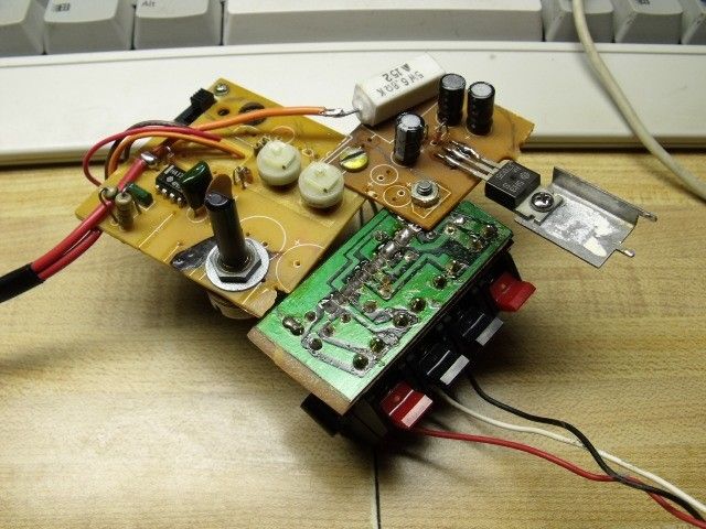

Something to consider for the cheap do-it-yourselfers. Attached is a picture of a servo control unit. Its made by cutting the servo control sections from a Uniden UST-6000 circuit board, screwing them together and connecting some wires. Ugly, yes but it works like a champ. The slide switch selects the vertical or horizontal position. The trimmers actually set the position of the servo, one for vert, the other for horz. The rheostat is a fine tuner for going + or - 20 degrees from the set position for those slightly off-skew satellites. The servo is powered by the 5 volt voltage regulator and the whole unit works off a 12 volt power supply. I noticed the UST-2200 also has a skew knob on the front panel and vert/horz adjustments on the bottom like the UST-6000 so it probably has a similar circuit board to chop up.
