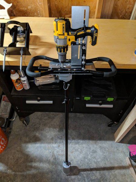

I use this with the foam concrete now for pole mounts. Takes about 15 minutes or so.

We tried one of those and it doesn't work very good in rocky soil.
I doubt it would in Western NY, either. The ground has a lot of clay in it and the shale isn't very deep in the areas near creeks and rivers. If you ever look at the Niagara River Gorge, you can see, it's all shale, for example
I used to own a company that built decks. Every Monday, my partner and I would go to the jobs we were starting and drill the pier/post holes with a 2 man, 6" auger. That clay made it real hard to get down to the frost line because the bit would just bind up and if you hit shale, the auger would just get locked in place.

I use this with the foam concrete now for pole mounts. Takes about 15 minutes or so.View attachment 136471
Yeah I'd be interested to see. It's a diamond tipped bit, and apparently they did a demo with one and drilled right through asphalt with it. I've only used mine once, well twice, on the same job(HughesNet and dish.) The ground was frozen, so I poured a little water in the hole as I dug, and it went pretty smooth.
