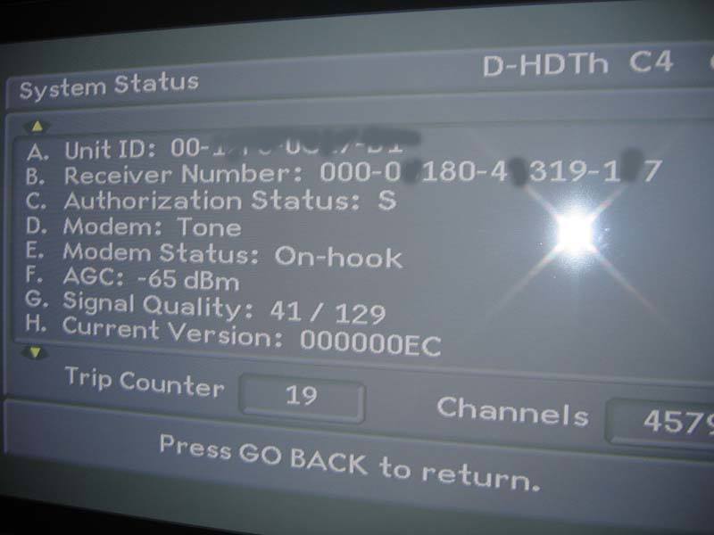

Hook it to a TV...press option on remote then 6 and then 5 to check system status....see if the Unit ID is still there, F's with all zeros (dead) or? let us know what you see...Suggest you not type in the entire nimber, but give us a hint like 00-*F45-4*77-B* (format) etc.
Attached is a shot of my screen with some of the numbers blacked out to protect my unit id...this is what you should expect to see

Like gizzer777 mentioned hook the 920 up to a television. After if powers up and the warm up goes away on the receiver display turn the receiver on with the remote. Hit the options button on the remote then 6 and then 5. The system status screen will pop up. Line A is the Unit ID. This should begin with 00-12FX-XXXX-XX. The X's don't matter so much as they are different with every receiver but it should start with 00-12F. If not the Battery has died and the unit ID isn't valid.
You can also call a programming provider like NPS and read the full unit ID to then and they can tell you if it is valid. If the battery has died the receiver is pretty much worthless. It cost about $170 to have it repaired.
