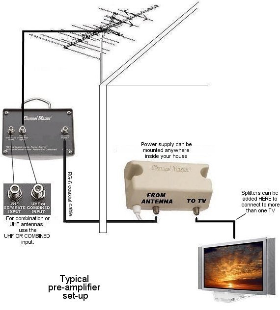

Thanks for the reply. There is no version number on the unit I have. Just Model CM-7778, UHF/VHF TITAN2 PREAMPLIFIER and FM Trap Control Inside - Factory Set "In". I have 2 AC/DC ADAPTERS/power supply. One is 12v and one is 15v. It seems that both TITAN2 preamps use the same power inserter. See picture below......
I'm just trying to see if any of the "splitters" I listed above can be used in place of this one.

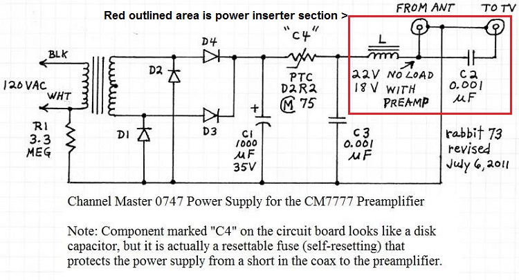

I don't think so. A power pass splitter allows the TV signal to exit to both of the out branches, but the power inserter is designed to allow the TV signal to only pass from the preamp side to the output side toward the TV while also allowing the current input from the power supply to travel back up the coax to the preamp.

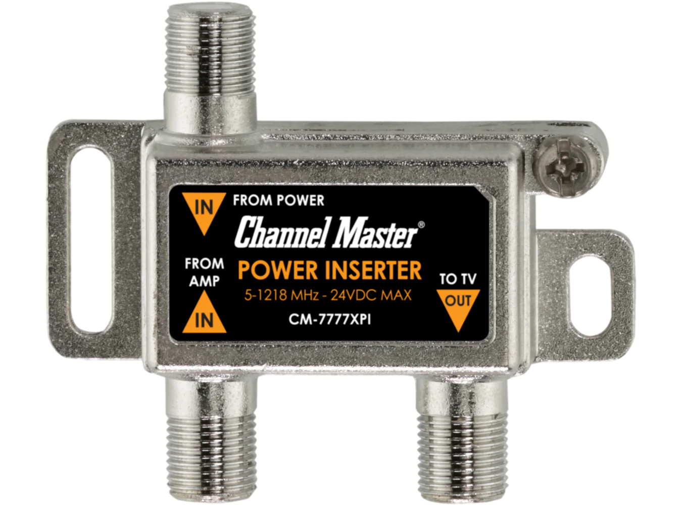

The dp PLUS SEPERATOR123254 is described as "This is a NEW DPP separator allowing a single line of coaxial cable to run all dual tuners if used with a DPP switch or LNB" so it's not a splitter.
The SWIM MSPLIT2R1-03 with DC power pass is for DirecTV and is described as "The SPLIT2MRV features one port (red) with a DC path for remotely feeding power back through the splitter up to the dish or multiswitch, making it convenient for indoor and outdoor use."
The Holland STVC 5-2150 MHz with DC pass is a satellite diplexer, not a splitter.
None of those will work for OTA, you need a true splitter and the splitter gets installed after the power inserter, not between the inserter and the amp.
