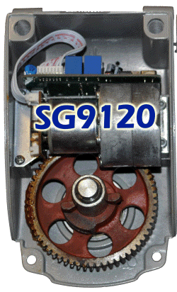

Does anyone know if the SG-9120 has hardware East and West limits?
I though the motor was similar to the SG2100 and the Geosat120, but I am noticing many differences.
Thanks.
The SG9120 does not have hardware East/West limits. Below is a picture. As you can see, the main gear has teeth all the way around.
Thanks for the reply and the image,
So how does the motor stop at around +/- 70 degrees?
Does it have software limits (hopefully permanent), or is there something else stopping it?

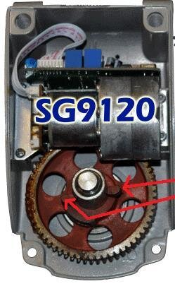

The two tabs pointed out in the attached photo will hit a sensor, which will cut power to the motor so it will stop turning.
You may have seen a website our there claiming that the SG9120 does not have hardware limit, but all that is, is just a marketing gimick trying to cut down the SG9120 with metal gear to make their plastic motor look superior.
You can set limits in the receiver menu, for East and West. I bought the SG9120 to replace a Sg2100 and there is "NO" play or slop with SG9120 unlike the one with plastic gear. I mean the dish moving when its windy. I will tell everybody to buy this motor. Just my 2 cent's and yes it came from WSInternational.
