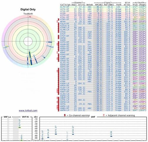

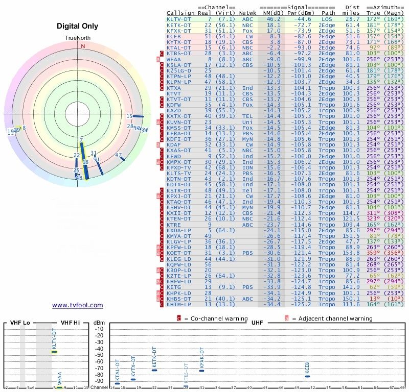

Attached is my original TVFool report. The antenna is an Antennacraft HBU33 and the preamp is an Antennacraft 10G212.
There is less than 75 feet of coax line total.

KETK NBC is 61.4 miles away with a 2 edge designation
KFXK FOX is 51.6 miles away also 2 edge
KYTX CBS is 73.1 miles away also 2 edge
The antennacraft HBU33 is rated for 60Mi. UHF in good reception conditions 2 edge means you have some interference between you and the broadcasters. Adding an amplifier does no good because the amplifier needs a signal to amplify. My guess is you don't have a usable signal from those 3 networks. ABC at 28 miles has too much signal going into the amplifier so the amp overdrives the signal.
You probably need a high gain UHF antenna such as a Channel Master 8 bay bowtie which also may receive your VHF ABC with enough signal to work. An amplifier is not a cure all in"IT" it might be close to GIGO, if you amplify garbage it is still garbage. You may also need more heigth 15 feet may not be enough. Post your zip code so we can play on TV Fool.

Using the Winnsboro ZIP code 75494 I get different results from what you posted so I am guessing you used your actual address. With 75494 your ch.7 degrades to a 2 edge station so you have a "good" location for reception. Taking your antenna heigth up to 50 FEET your ABC and NBC improve to LOS line of sight and others improve to 1 edge. My conclusions are you need a better UHF antenna and more heigth. Seeing your actual location may have more elevation than the center of Winnsboro you may not need 50' but you do need more than 15'. Go to TV Fool and play with the antenna heigth at your actual address to see how low you can actually mount the antenna. With additional elevation wind resistance becomes more important so the 8 bay bowtie is favored and the possibility of also getting ABC's VHF signal is my reason for the CM4228.
