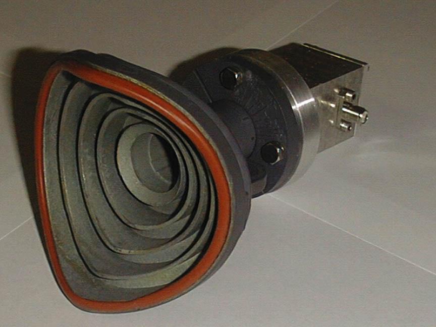

It is working great. The other 2 Primestar LNB's don't have a lens over the eye, I'm afraid water will get into them...
The picture is not of my LNB but the feedhorn looks the same though, is the lens cover missing or was it made like that? I'm worried if I use it rain will cause me problems.
