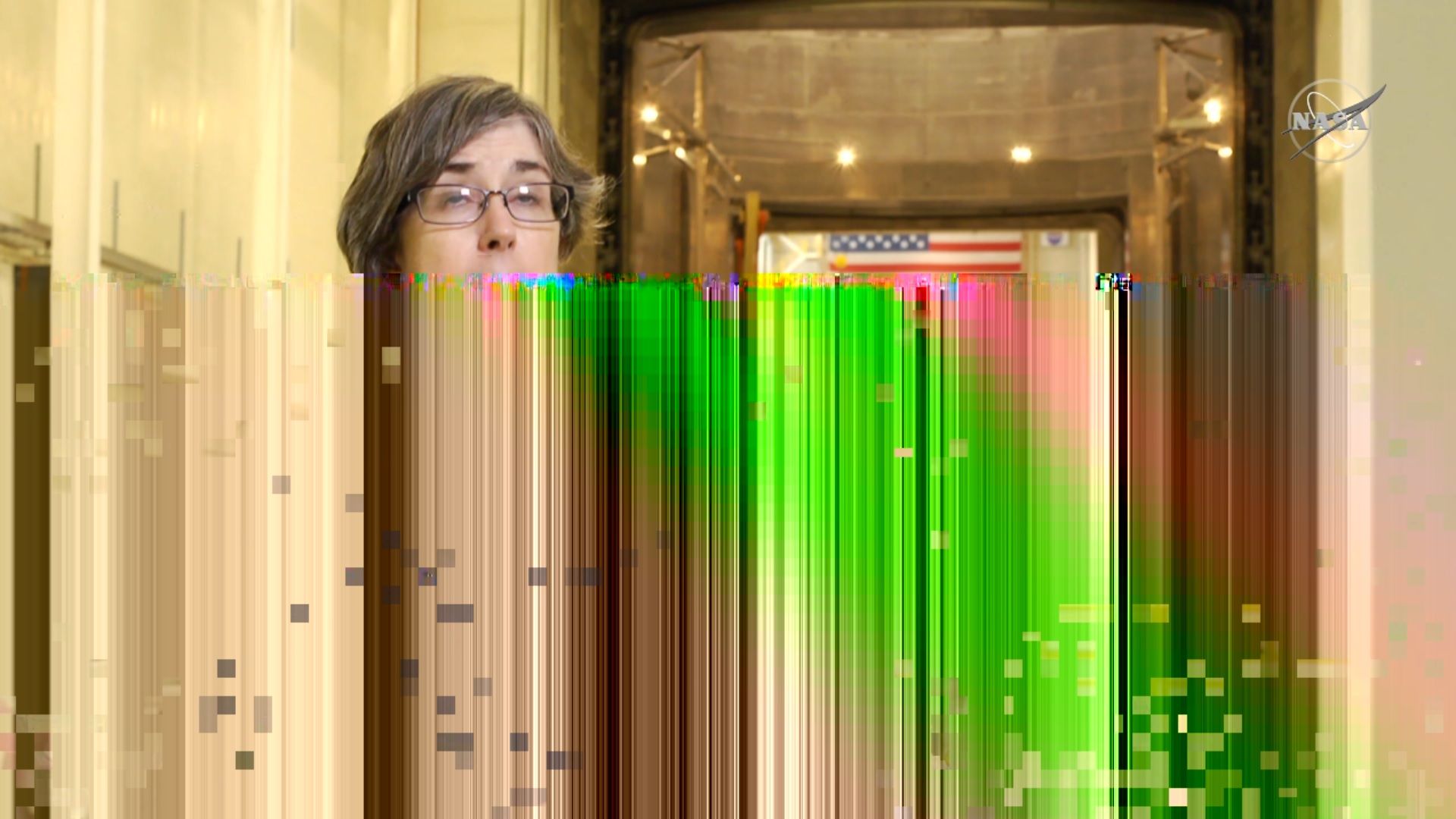

I'm using Prof 7500 usb dvb-s2 card and i'm dealing with the problem of getting noisy & pixelated picture continuously once i start to turn on the existing channels on 8PSK modulation frequencies lately.(attached file)
The singnal strength & quality numbers overally are the same as before and look ok in those frequencies, Although I lose the signal several times for a couple of seconds (especially at first minutes after turning the device on),It goes back instantly then.
While simultaneously, there's no problem on QPSK frequencies (both HD & SD channels) no minor signal lost and the received picture is perfect.
Can I have some guidance to fix the issue please?

It sounds like windy conditions or too small of a dish or dish alignment. You'll need to check your receivers C/N for that signal and see if it's sufficient for the modulation and FEC that you're trying to receive. I'm not sure if it would be a USB or OS (Windows or Linux) issue.

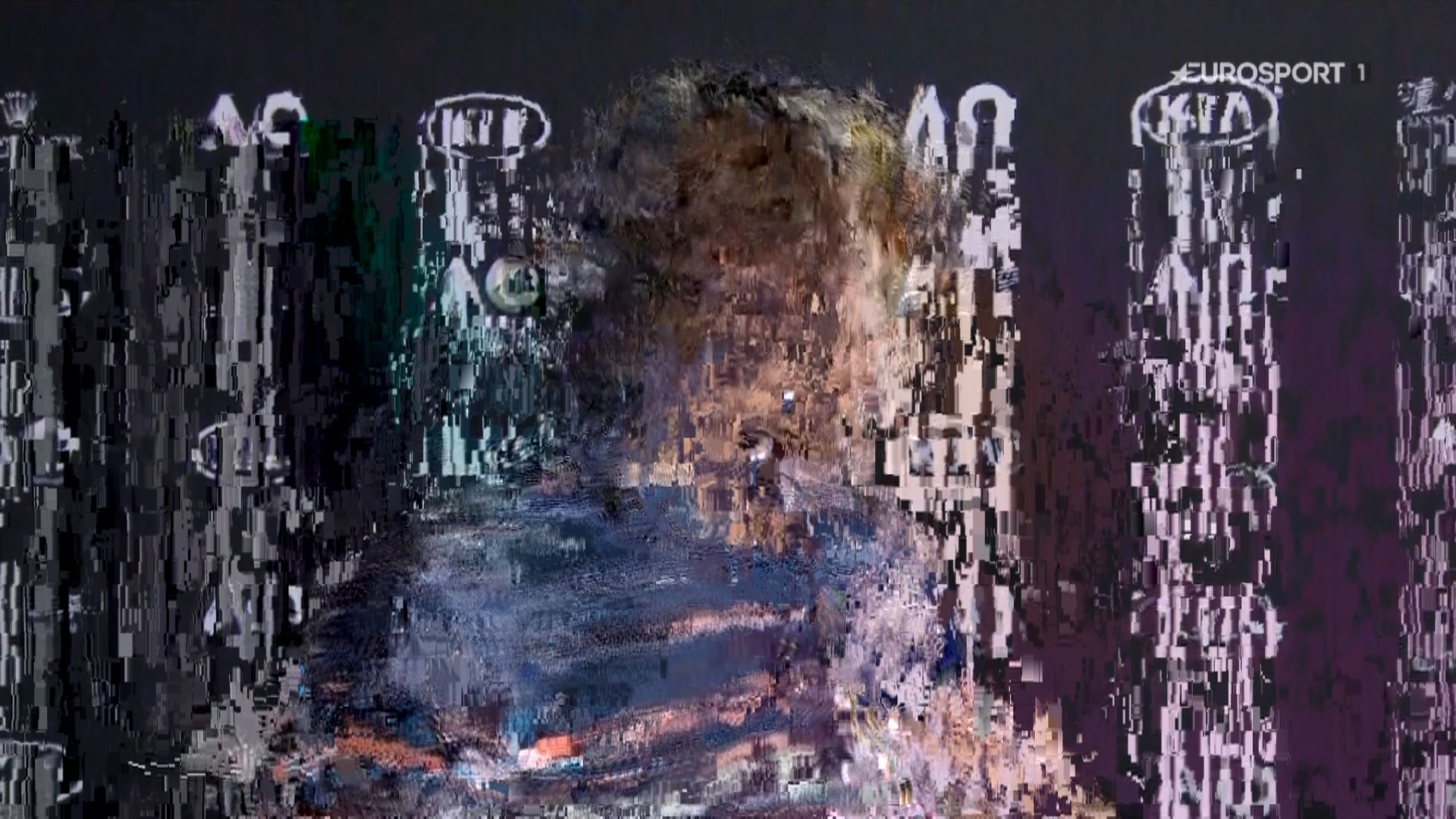

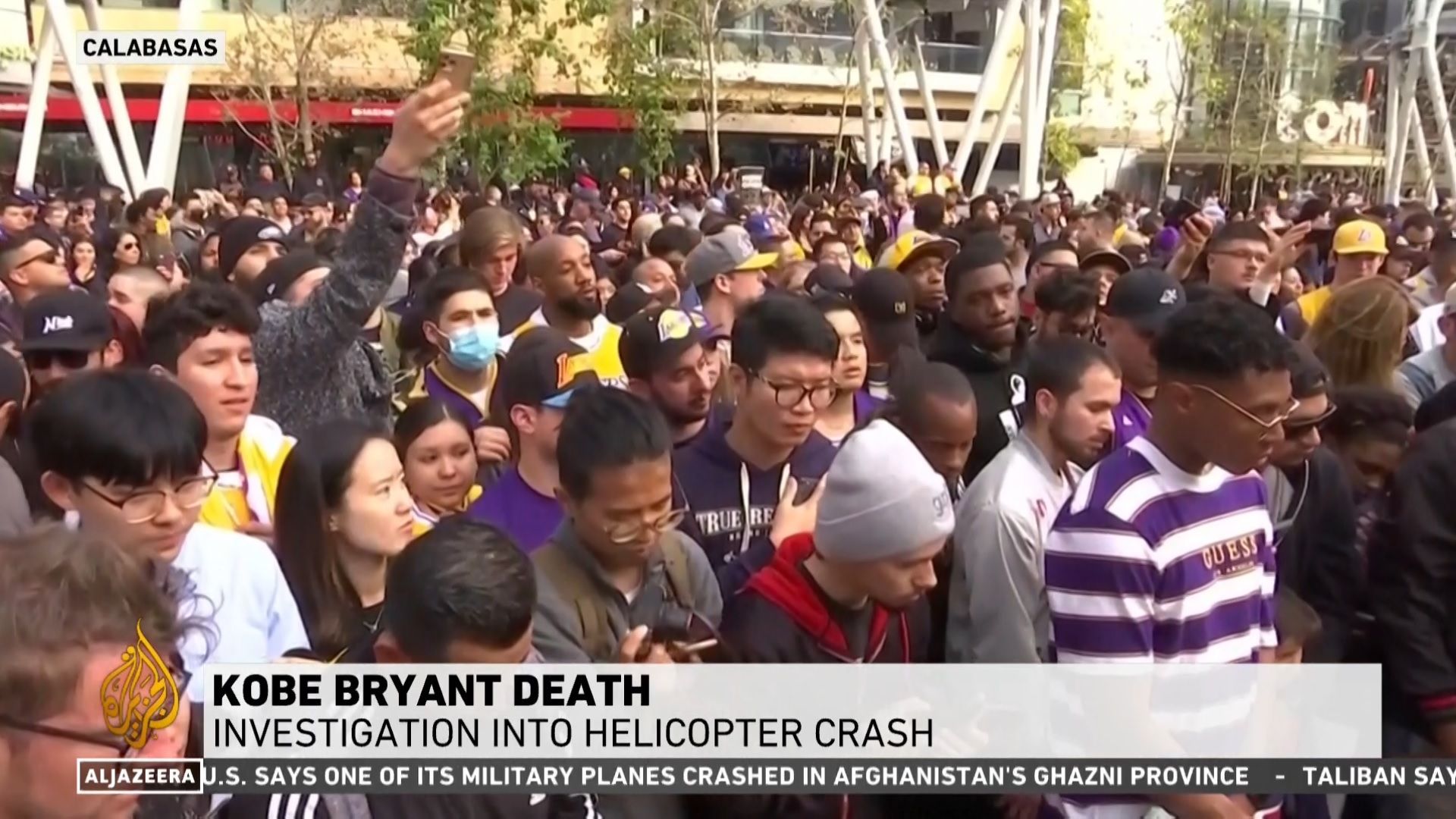

On every single channel in 8psk the problem comes up , On channels in Qpsk everything is OK indeed ( look like the attachments)
I checked dish alignment as well , It sounds like as usual.

Finally I could just borrow a friend of mine's HD receiver and tried the case out. I never changed my satellite dish alignment or adjusting LNB and something else setup , everything related to antenna was left unchanged during the test indeed , and yes the picture on the screen in every modulation and channels was perfect by the HD receiver . I just found out my problem derives from the dvb-s2 card itself . Replacing drivers and AC/DC adapter (has the same specs) had no effect too.
