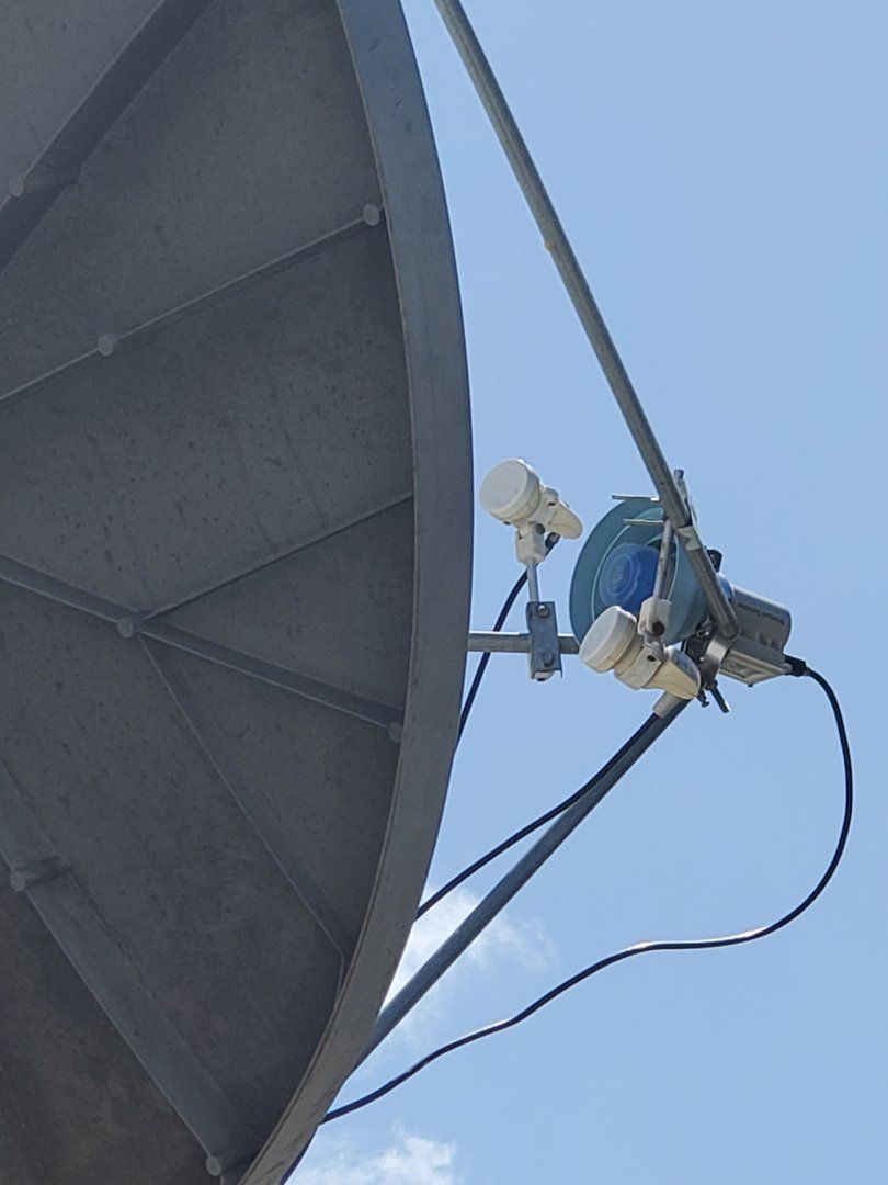

In Montego Jamaica right now at my second home. 6Ft channel Master dish Cband on 105w the 4 NBC mux I thought it was live 24hrs but most times it's just blank most of the time, Ku is on 97w. I tried 99w I got the lesea channels but not the Puerto Rican Mux on 3827.
Are there any 24hr american news channels available?

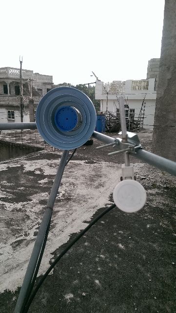

I was able to receive the 87w and the cnn feeds once but not the pbs. got 99w Cband but not the news channels. I would like the 125w pbs but also want 97w on the same dish. I don't think that is possible though.
Right now I am parked on 105w for the NBC mux but will try to see what I can do about 125w. Maybe need to park between a satellite that will allow to have 125 and 97w as sidecars
125W Ku is only 42dBW in Jamaica, and is never an easy target from anywhere, so I doubt you can get away with a sidecar LNBF.

87w was able to get it last year but not this year at all. Also I should be able to get 125w but there is a building blocking the signal and I am not able to move the dish I am able to swing the dish to 113w and get great signal maybe 117w. But not able to get any pbs at all
