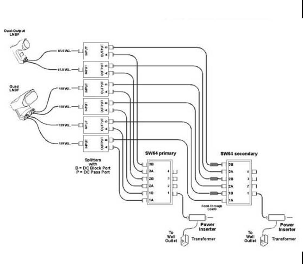

If I'm not ready to change my LNBs at this time. What switch will give me the maximum ports out?
If you're gonna keep the Legacy LNBs (not recommended), the SW64 will give you a total of 4 outputs. Cascading gets a little too complicated with Legacy switches, that's why I don't recommended.
See picture below:
