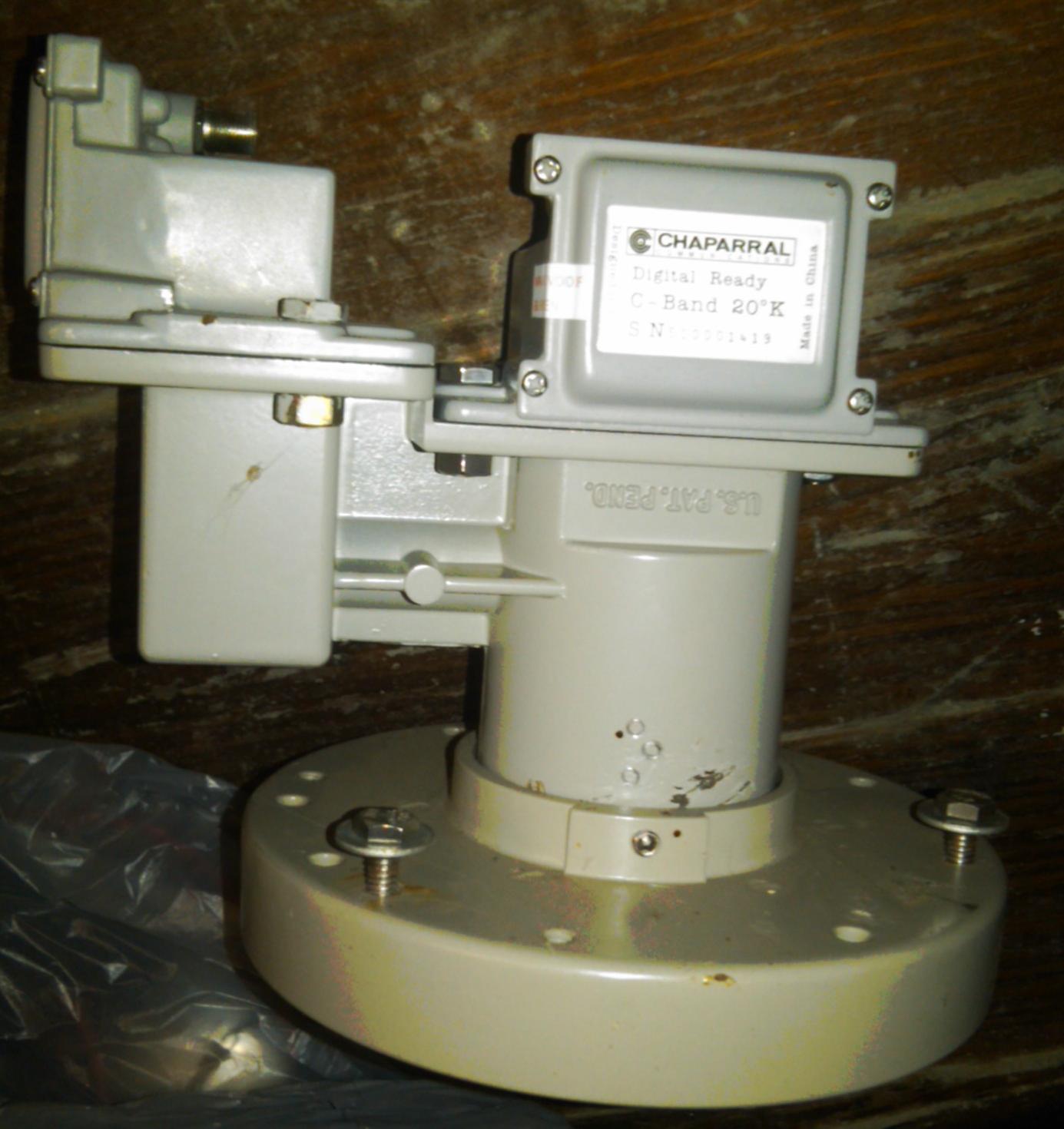

Yeah Anole that old feedhorn is just that..a feed horn with no probe. It is open all the way to the pickup of the device that was being used...ie lna lnb etc..
