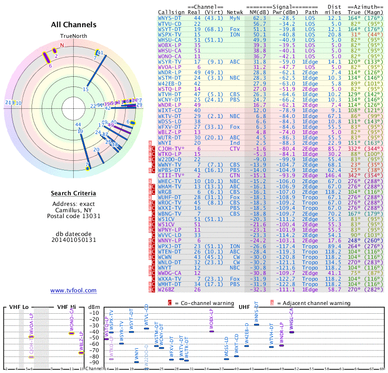

Here is my results. Hope this helps. The channels I watch the most are WNYS, WSYT, WSYR, WTVH, WSTM. I am using RG6 coax as well. On Solidsignal.com the MS2002 comes recommended to my zip code of 13031 so I figured I would be good to go which makes me wonder if there is something wrong with the antenna itself. I see that the DB4 is discontinued and it has been replaced with the DB4E. However, according to Solid Signal it is not recommended for my area...for whatever reason. I basically need an antenna that can point in 2 directions at once....

I don't understand, all the major networks are between 120 and 164 degrees, with the weakest ones at 134. Why not aim your fixed directional antenna at 134 and get the other (stronger) networks off the side? Did that not work? Because omni directional antennas are awful, for the most part. Multipath, not weak signal, is the biggest killer of digital TV reception.
