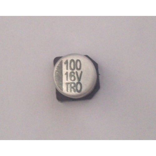

today i remooved my card and saw one of capacitors was separated
do you think my proproblem because of this?
check the dmesg, is the cx88 driver still complaining it cant determine what card it is? its defn odd you dont have a subsystem ID, thats usually held in the eeprom.
I cant tell from the picture, did that fall off the card or something? are you able to fix it?
UDL
Can you solder it back on? or is it non serviceable ?
will it work after that? maybe... what was the part number on the board? starts with a C like C23 or something
UDL
no because one of legs is broken
the part number on the board is EC3

ok ec3 is a 100uF 16v capacitor
Its used a part in a filter for the 3v pci bus, not having that is not critical in most cases. Just a good idea.

i removed prof 7301 from motherboard and i should find that capacitor to replace so i want install tt s2-3200 for now

i will replace prof's capacitor and test it again
