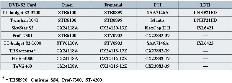

Attached is a table of chipsets used in some popular DVB-S2 sat cards.
Hey great bable of chipsets, now about the prof revolution 8000 PCI e and the TT-Budget S2-1600 one is PCIe and the other one is old PCI, here is the link of the specs for the STB6100
now what's the difference between STB6100 and STV6110A?
