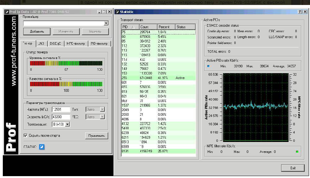

Interesting pic posted on High Bit Rate DVB-S2 8psk signal reception with Prof-7301:
12591V43200 – 2/3 DVB-S2/8PSK from Intelsat 4 (72.0E) - calculated card data output rate higher than 85Mb/s. :)
