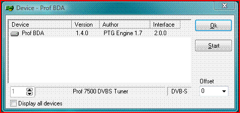

What shows in the "Devices" dialog box for DD? Could you perhaps post a screenshot?
The dialog box shows "File" under device but no Prof. Its showing in the device manager, under "sound, video and game controllers". I have mytheatre working, unfortunately I cant move the antenna.
I'm not following the "File" part at all. See the screenshot of how it should look under Vista/DD 1.4i. Could you post a shot of what you're seeing?

I have DD 1.4/Prof 7301 & 7500 receiving S2 signals without any problems, and sending all forms of DiSEqC commands. Posting a screenshot of your DD Device dialog box might help figure out what is different between our setups. What is in your DD Devices folder?

Try taking everything out of the devices folder, except for the bda.dev module that is on the Prof installer CD. The bda.dev module that installs with DD does not have the capability of DiSEqC commanding, and may lack S2 also.
