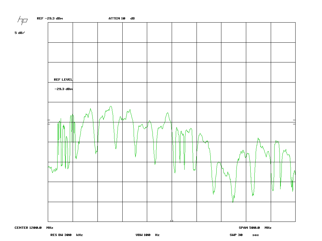

New subject. Since we're talking about this in the 'kitchen-sink gizmo' thread, I'm attaching some shots of Intelsat 9 (58W) C-band vertical polarization spectrum swept by the Prof 7301 card from my 1.8m with a few lines of driver hacks compared to my bench SA. I wouldn't want to live without the latter, but the former will do a lot of what people need. Both the SA and BLSA provide additional frequency resolution. The 7301 vertical scale isn't calibrated, because I'm still working on that. The scan took about 12 seconds on the 7301. That was just a gut setting I made for testing. It might work as well faster, or might do better if slower. I haven't done any comparisons, yet.
  • Intel9V-7301.pdf
    Intel9V-7301.pdf
