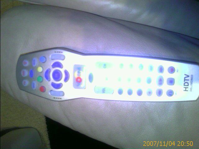

My Voom remote definitely does not have a button labeled VCR, but oddly enough it does have playback control buttons -- maybe for a DVR function thru the Sat box??? In any case, it still seems that it is a different version of the remote as described in the FAQ. I have attached a (not very good) picture of it; can anyone confirm that it is different and if so does anyone have one of these and know how to program it?

Thanks for confirming that. So the mystery remains; are there different steps to program this version of the voom remote to control a TV? Any ideas on what else to try? The fact is the voom installer got this remote programmed for my TV way back when, and after trying to program it for a different tv since then unsuccessfully, i went back and tried to re-program it for the original set using the FAQ instructions and it would not work even with that set (and i can rule out a defective remote, because i have 3 of them with the same results!) So I suspect that a different procedure was used to program these. I don't know how to contact the installer who did it originally or I'd ask him. Anybody out there know any former voom installers they could ask?

I thought I would update this thread with a solution that I discovered later in case others have this problem. What I discovered was that when holding down the CH up button the remote apparently cycles through the commands too fast for my TV to respond to the "turn off" code even though it did at some point generate one. So how did I eventually get it to save the right code? Well I noticed that while holding down that button I would sometimes see an LED on my TV blink which I figured meant that it recognized a command, and when that would happen I would release the CH up button and then hit the CH down button sequentially (not holding it down) and eventually the TV would go off and it was now programmed correctly!
