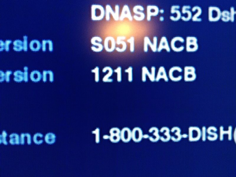

It just will not take a hit so no TV. Not looking for any software ver just a working hopper.

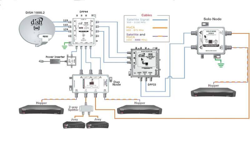

I see. Here's a diagram I made of a three-Hopper setup (I now have four.) Maybe it will help.

I just got on to make sure your diagram was the same as the one in my mind since I've never actually tried it. Do you actually have a DPP33 like the picture? I miss those...
Yup!

They are. Half the cost and no power inserter.

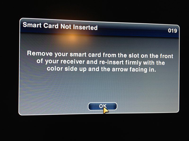

So the new refurb junk in the trunk showed up today :) got to step #5 auth ... Froze and then click click click click reboot and bam.
Replacement #3 on the way lol. Grrrrrr
