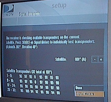

I have been running a modified Slimline dish for a couple weeks now and wanted to prove something to myself. The Slimline is being used for 101 only. I put a single LNBF on it for an 18" dish.
Well today I tossed the SL3 LNBF on it to see if I could add anything to the signal with it. It actually lost points. So I put the 18" LNBF back.
I attribute this to the single LNBF's throat had a a larger throat which allows more of the reflectors surface to focused into the LNBF.
Anyway the moded dish will stay as my mainstay. I do really like the dithering adjustments on the Slimline (that is top shelf)
It's always better at least in my book to have the most signal you can. :)
The second picture is the final maximum signal levels on the moded Slimline. The numbers that look like 93 are actually 98 (bad camera angle).

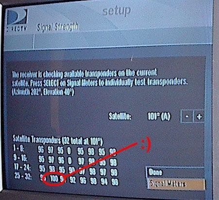

I dont think I've seen a 100 on a D* meter......
I know most of my signals are between 93-98 on all 3 sats so I'm fine with that....the meter on a D* ro E* receiver doesnt work the same as a FTA receiver ;)
One must remember that the values shown on the signal strength screen are not equal to quantity, but the quality of the signal.
I would figure the numbers on the screen are a Quality reading, taking BER and gain into consideration. The higher the EBNO the higher the Quality.
I broke the meter :D

I take the weakest conus transponder and max it out, that's how I've been doing it.
That's TP26 on 101 which is one of the six spot beams. I've seen one at 100. And right now my HR23 is reporting 100s on non spot beam TPs 6, 8, 14, 16, 22, 24 30, and 32. Don't know why exactly, but it's okay by me. :)
