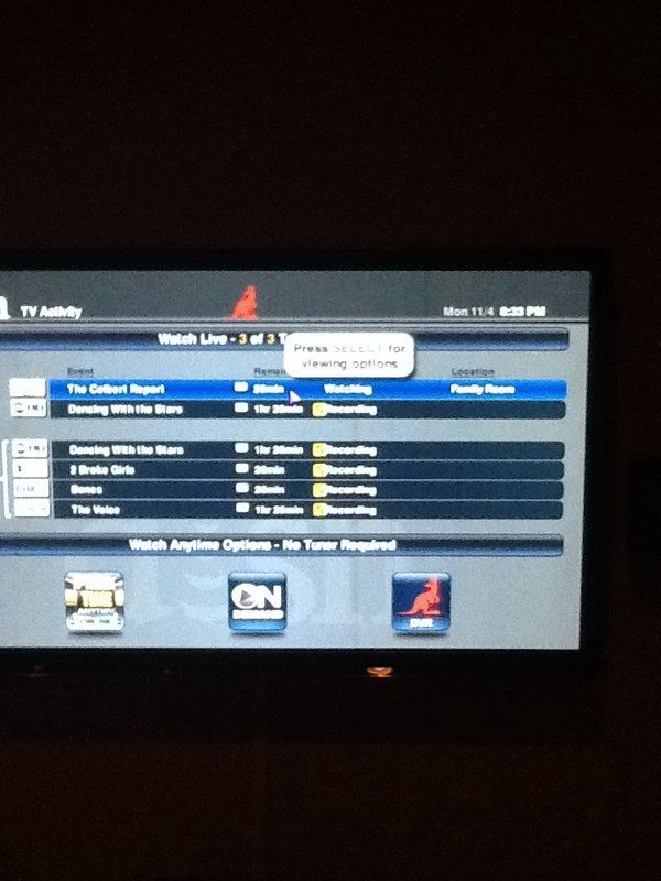

jcvaughan SatelliteGuys Pro Original poster Sep 7, 2005 171 16 Pacifica CA Nov 4, 2013 #1 So this happened. PTAT using another tuner for the same show and I can't stop it. Attachments image-21033003.jpg 63 KB · Views: 212
KKlare SatelliteGuys Pro Nov 18, 2003 2,397 14 Los Alamos, NM Nov 5, 2013 #2 Could it be that one is HD and the other SD or some other map-down channel with the same program? The picture is too blurry to see the details. -Ken

JSheridan SatelliteGuys Master Lifetime Supporter Feb 16, 2008 8,961 10,186 USA Nov 5, 2013 #3 jcvaughan said: So this happened. PTAT using another tuner for the same show and I can't stop it. Click to expand... Just turn the Hopper off for a few seconds then on again and it should sort itself out. We see this a lot, especially just after 8PM when PTAT starts and another recording is in progress.
