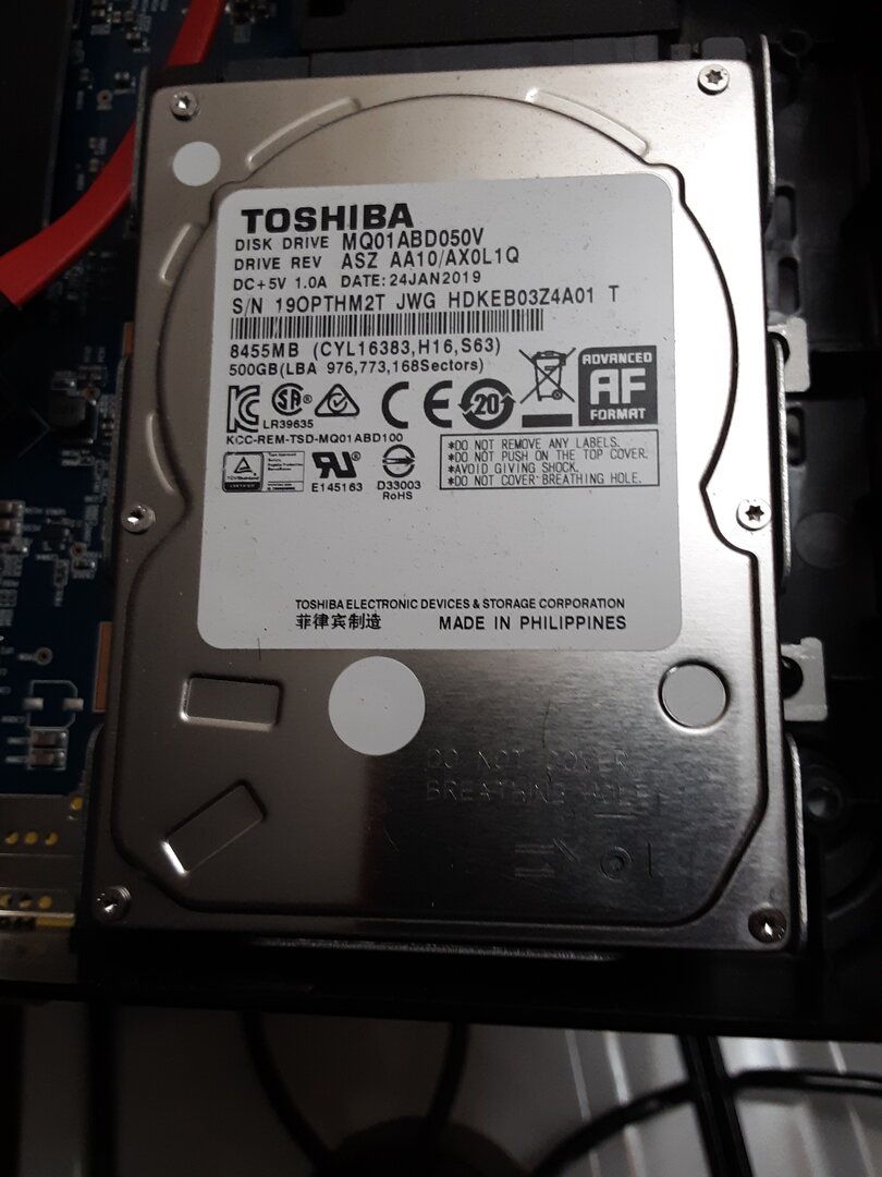

The Orby HDD.
Anyone know capacity and can it be used for PC backup or other?
Oops, I see it now- 500 gig

It's just a standard notebook hard drive so you should have no problem using it for other purposes. :)

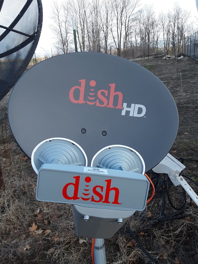

Speaking of problems though. After the installer left yesterday, I found the diagnostic page and did sig quality test on 61 and 72 and was shocked to see between 45 and 60%. One was better than the other. What a pitiful little frisbee dish he put in (25x20"). This morning had pixelation on all channels except my OTA! OTA q was 100%! It's OK now, but I remember the guy was having trouble with his meter and the wind was HOWLING, so maybe it could be tuned better. I'll check it out later today, and if that's as good as it gets, I'll call em and tell em "You need to come out and fix YOUR sig/pixelation problem." LOL
Anyway, getting back to your question, I don't need the Orby doorstop, but maybe could use the drive. I see fleabay has encosures with USB terminals, typically for around $6 - $10.

Knowing you should stay off a ladder is the first step to being safe!! :drunk Besides it sounds like you have lots going on. No time for a ladder any way my friend... Is the dish that got installed the dish turbo style?
Yah, have a 20 acre hobby farm/orchard/vineyard/garden that takes all my time. My boat hasn't been in the water for 5 years. Have to prioritize my time. Golf was the first casualty, fishing the next, and now FTA.
I don't know what a turbo dish is, it's just a pitiful little thing with 2 LNBs and switch combo.

I did exactly that years ago. Even so, it only brings up the signal level about 15 points, so on full-black full of rain storm clouds, it only kept the signal a little longer than a small Dish dish. You should be getting MUCH better signal from the dish the tech installed. IMO, something is wrong with his installation.

Looking inside, I wonder if lifting the drive out would alter the ability to receive Orby signals if there were any? Only 2 HDD cables; 1 looks like 5V power, and the other, thicker cable is probably data in/out? Makes me wonder if both rx and DVR boards were the same, but the designated DVR box was nothing more than a rx with a hard drive plugged in?
Also wondering; since there was no menu for freq, sr, polarity, etc, doesn't seem likely Orby rx could receive or process sigs from another satellite, making it useless for any FTA use?
Beyond receiving signals, I wonder if it would even boot without HDD.
No, in current state orby box is mostly useless (OTA only right now?) it seems :crying

Well, again yesterday and today, having pixelation making one of our fave channels (Grit) and some others unwatchable. This morning I got back on the diagnostics page to see the sig quality, and it was bouncing up and down like before. Happened to see a section labeled "tuner", and and it was set on "2", so, not knowing anything about Dish boxes (apparently there are 3 tuners in this box), I changed the setting to "1", and the sig was a rock solid 51 with no movement at all. Just dumb luck! Channel is great, no need to call Dish now. Even a blind squirrel finds a nut now and then.

I wonder what that setting does? Did it disable one of the tuners? Was it just something the tech miss-set? Hopefully somebody here knows, and lets us know. There are some real Dish installers here.

I have a Seagate 500 gig drive that I used for the DVR on my FTA box. Pulled the cable off the front and plugged it into the Orby drive and plugged the USB end into my PC. Nothing... the PC does not even show this drive connected, or in the list of drives, so... I have to think the drive is pretty much useless for anything but Orby. I can hear the drive running and the LEDs flashed once or twice but nothing else happens. I ordered an enclosure, maybe it arrives, it will make the Orby drive work?
The last tablo player I bought takes a sata hard drive. Once you connected it to tablo, you had to format hard drive. The tablo has a menu to format the harddive. So if you still have the fta box maybe you can format it with your tuner box.
