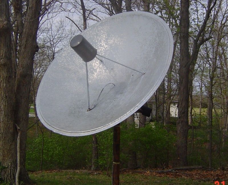

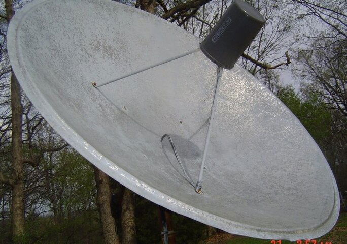

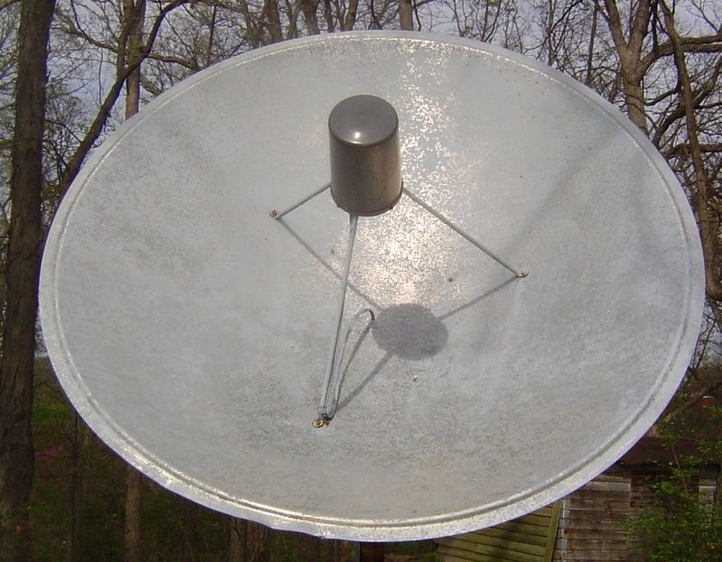

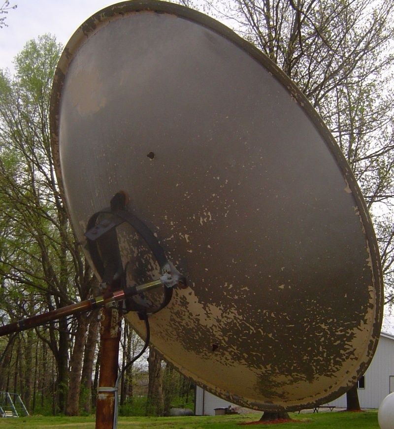

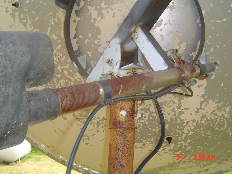

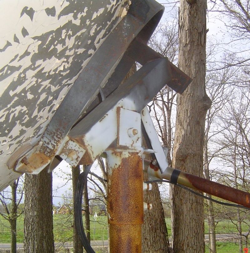

I stopped by and took some pictures on my way to a friend's wedding reception, and put a magnet to it.
It is definitely not steel and looks to be aluminum. Magnet will not stick.
It is a little strange looking, and the mount is strange looking. Maybe not as strange as I think, but different looking than what I am used to seeing. There doesn't seem to be any dings, warpage etc., inside the outer ring. There are a few dings outside the ring.
Here are the pics:
P10 solid front P10 solid front2 P10 solid side angle
Rear mnt center Rear mnt left Rear mnt right
I will need to get the old paint off somehow, and paint it up good and put new bolts on. I have an air compressor, I might as well buy a paint sprayer and skip the cans. :D
Is it ok to sand this dish to get the old paint off? Or what is the best suggestion to prep it for painting?

That looks like an old Hydroform dish. They were shaped by a water-filled bladder pressing the aluminum into a parabolic mold. I think the original company was VSE (not sure) then Paraclipse started selling them. I use the Paraclipse version now and gets excellent C & Ku reception. I don't remember Perfect 10 making a solid dish, so it might just have a Perfect 10 feed cover.

peeling paint
Has anyone suggested a pressure-washer for blasting off the flaking paint?
I don't know how much force they produce nor how soft the aluminum is, so keep that in mind.
If it works, it'd sure be a heck of an easy way to clean up a solid or a perforated dish.
The way a car chassis and body would be cleaned, is with media blasting.
That's where they use walnut (?) shells blasted against the metal to peel off any coating or rust.
It's a step down from sand-blasting - less harsh - and won't hurt the underlying metal.
There're a lot of ways and finishes to protect the metal.
Anodizing would be great for the aluminum, but probably expensive :cool:
You could powder-coat most any metal.
And people who do that sort of work might have an oven big enough for a dish (or parts of one).
I've had stuff powder coated before, and would give that a serious look.
I don't know about some sort of anti-corosion protection you might put directly on the bare metal.
For the parts of the mount or dish that was steel, there are several choices.
For aluminum, I think the choices are quite different .
Anyone know what they use on aluminum parts (wing spars, screws, etc) for use on airplanes?
