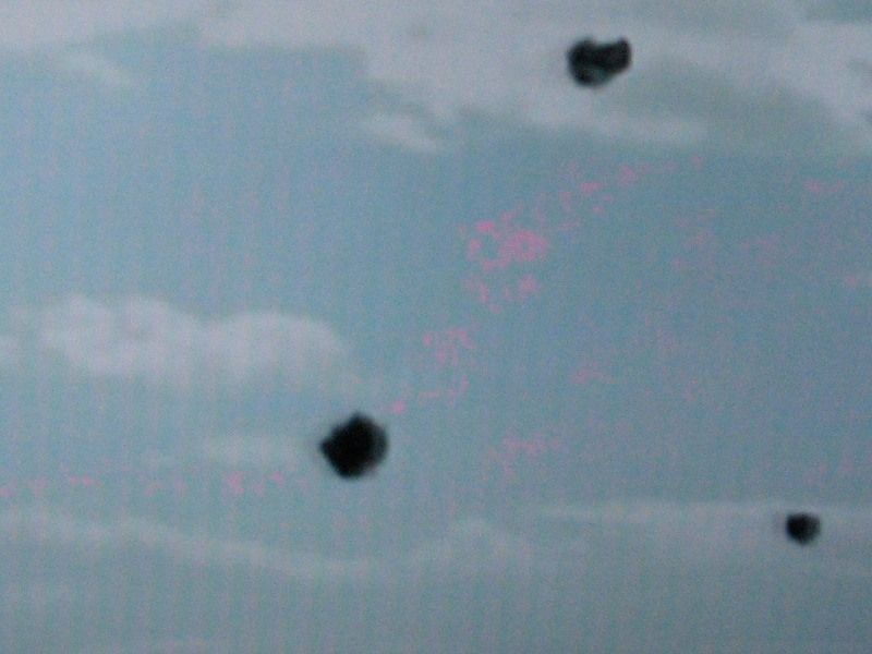

I just purchased a Samsung LN40A550 and just love it! My Oppo upconvert player looks fantastic. I do however have a problem with D*, I think. I've hooked my Oppo to both HDMI inputs and the problem isn't there. It's only with my D* receiver, H21. I've hooked up an old bat wing and my OTA locals don't do it either.
It happens mostly with blues and greens where there are patches of red pixels but it's never in the same place. I took a photo of it below. This only happens with D* and just has me wondering if this is common with Sat. compression and LCDs? I'm just concerned and want to trouble shoot this before my 30 day return is up, just in case something is wrong with the set.

I've got a H21-200 and I haven't seen that. Have you tried component cables to see if it also happens with that interface?
Hmm, tried everything else so why not. I'll give component a shot and report back in a few.
Thank you so much rad. I tried the component cable and the picture is perfect. Looks like it's a problem with the HDMI connection on the H21. I don't know why I didn't try component sooner, guess I was on a one track thought and just needed a fresh perspective. Again, thank you.
NP, now the b*tch is trying to figure out if it's the H21 or the Samsung with the problem. I'd contact DirecTV and tell them about the problem and see what they want to do.
I'm 99% sure it's the H21. I had my Oppo hooked up with an assortment of HDMI cables with no problem, albeit the Oppo really is a DVI to HDMI connection. In fact tomorrow I am going to test all inputs, component, HDMI and USB on this set. Then I'll test the H21 on all 3 HDMI inputs with different cables.

Well just for grins and giggles I ordered two more HDMI cables from mono price. So if my Oppo cable, my Acoustic Research cable and these two new ones from monoprice give me the same results then my next move will be to get D* to replace the H21. Trying to get this done in 30 days is going to be a bit of a rush. I still think it's the H21 but we'll see next week when the cables get here.
my guess is the cable.
Not all HDMI cables are created equal !! (despite what many say )
Do you secretly work for Best Buy???:D
I think Gregg means that they have different specs; not that you must spend $99 just to get the needed spec cable. Maybe the user has a v1.2 or 1.3 and that a 1.3a cable would solve the issue.
Just wanted to update you guys. My new HDMI 1.3a spec cables arrived from Monoprice today, hooked one up and all is well. Gregg's comment got me to thinking and I did some digging and found my older AR cable to be 1.1 spec and of course my Oppo DVI to HDMI didn't present a problem. Thanks again guys for all your help.
